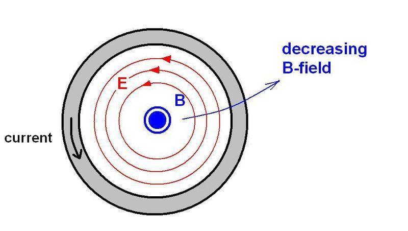

3) Yes, the magnetic field will create a force that points towards the center, and it will help provide the centripetal force.
Oh, then how about the situation in the picture? :wink:
  • Diagram of a conducting ring viewed from above, with a current arrow along the ring, a circular red E-field loop inside it, and a blue B-field dot at the centre labelled decreasing B-field.
@hikaru1221: The interaction between the electrons and the conductor is the cause of it's resistance, no? So if it's a perfect conductor, with zero resistance, should only the current flow?
And yes of course if the magnetic field create a force that didn't point towards the center, it would work against the direction of the centripetal force, and so the inside bonding forces would have to be greater.
@Tusike: I wouldn't dare saying much about super conductor and perfect conductor (the former deals with quantum effect, while the latter is just a theoretical concept). Anyway, say, a model for such perfect conductor is a frictionless tube containing negatively charged balls (electrons). The tube is positively charged, and so, E-field exerts forces on it. However, the tube has very large mass, so the effect is not as recognizable as that on the balls.

Why is it not equal?
If you consider a very small part of the conductor, you can see that due to the flow of electrons, there is a magnetic force which acts exactly towards the centre.
Does pointing towards the center mean it is the only radial force?
Centripetal force = radial component of the TOTAL force.
No it does not mean.
But there is no other force which will have any component towards the center. Only two forces are operating - force due to electric field which is tangential and force due to magnetic field which is radial (ignoring forces due to further induced fields, if any)
I wonder what will be the effect of that centripetal force on the movement of electrons.
Last question - Does the ring acquire a constant angular velocity or it keeps on increasing ?
I think it will acquire a constant angular velocity due to the rotational impulse received from the electric field. B appears suddenly but it will be constant after that.
What about tension inside the ring?
