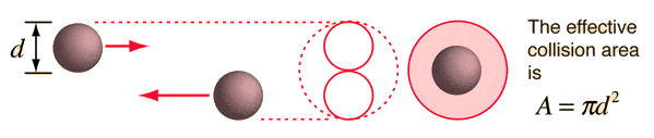

found this picture in hyperphysics
http://hyperphysics.phy-astr.gsu.edu/hbase/Kinetic/menfre.html
so based on this picture what i perceive is that the πd2 part is calculating the area of collision which has a radius equivalent to that of the diameter of the particle so hence the d is not the diameter of zone but the diameter of individual particles but in our case the particles are not similar hence the radius of zone is the sum of radii of the two particles
Ah, the initial formula is for non-point particles already.
Okay, your result is right. I misinterpreted the formula.
