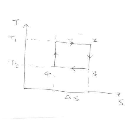

I think in a moment you will realize that your statement is untenable.
Consider a http://en.wikipedia.org/wiki/Carnot_cycle" . For the benefit of the uninitiated reading this, the Carnot cycle comprises four processes that connect four equilibrium states. It describes the operation of a ideal heat engine of maximum efficiency.
Read more at the Wiki page. But note that by definition each process is reversible.
So Andrew, consider the processes 1-2 and 2-3 that connect states 1 and 3. Isn't it obvious the processes 1-4 and 4-3 (the reversal of the direction of the processes in the figure) also connect states 1 and 3? And clearly 1-2-3 and 1-4-3 have different heat transfers, and different work transfers? (But ΔQ-ΔW = ΔU = U3-U1 is the same.)
Exercise: show that even though Q123 and Q143 are different, the integral of dQ/T is the same for both processes.
Oh, and Andrew, the specific answer to your question is that process 1-2 is reversible and isothermal. Process 1-4-3-2 is reversible and not isothermal and has a different work and heat transfer from 1-2.
Well, that's true. I see your point.
An adiabatic expansion followed from 1-4 by an isothermal expansion from 4-3 will get you to the same place as an isothermal expansion followed by an adiabatic expansion. That results in less work being done and smaller heat flow into the gas but the final state is the same.
And I suppose you could break the adiabatic part into two parts and have a path with a shorter adiabatic expansion to a temperature higher than 3 followed by an isothermal expansion to a volume less than at 3 followed by a second adiabatic expansion to 3. Or you could have a longer adiabatic expansion followed by a longer isothermal expansion followed by an adiabatic compression to 3. &c.
Ok. I agree. So you are right, there are an infinite number of possible reversible paths with different dWs and dQs so long as all heat flow occurs isothermally and all changes in temperature occur adiabatically. Although the dQs are different for the different paths, \int dQ/T is the same. Good point.
AM
It has been most interesting watching this discussion from the sidelines, and restraining an impulse to jump in and post.
However since this was originally about temperature and entropy I think it appropriate to add a TS diagram to the PV one of bbbeard.
go well

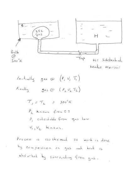

I looked up Engel and Reid's 2006 edition. Here are the problems I think the OP had in mind.
Example Problem 5.7
One mole of an ideal gas at 300K is reversibly and isothermally compressed from a volume of 25.0 L to a volume of 10.0 . Because it is very large, the temperature of the water bath thermal reservoir in the surroundings remains essentially constant at 300 K during the process. Calculate the entropy change of the system, surroundings and their sum.
Example Problem 5.8
One mole of an ideal gas at 300 K is isothermally compressed by a constant external pressure equal to the final pressure in Example Problem 5.7. At the end of the process, P=Pext. Because P≠Pext at all but the final state, this process is irreversible. The initial volume is 25.0 L and the final volume is 10.0 L. The temperature of the surroundings is 300 K. Calculate the entropy change of the system, surroundings and their sum.
I don't have this book, but I'll make a start on 5.7.
For the gas ΔS = Rln(V2/V1)

I have been thinking about how the conditions in the questions might be effected and here is what I have come up with.
The gas is confined in a thin rigid but thermally conductive bulb immersed in a liquid bath.
Leading to the bulb is a tube from a substantial header tank of a liquid that does not interact with the gas, via a tap. The level of the fluid is such that the pressure in the pipe is the desired end pressure.
At some time the tap is partially opened, allowing the liquid to compress the gas, at the sensibly constant pressure of the header tank, but at the same time controlling the rate of compression so that the temperature in the bulb remains sensibly constant.

  • #45
Andrew Mason said:
If the temperature of the gas and the surroundings are the same it can be isothermal only if it is quasistatic.
I am saying that it can't be quasistatic, hence it can't be isothermal, if there is an initial finite difference between the external pressure on the gas and the internal pressure of the gas.
So in order for problem 5.8 to make any sense I think you have to replace "is isothermally compressed by a constant external pressure" by "is compressed by a constant external pressure" and add "At the end of the process, T=300K." where T refers to the temperature of the gas.
AM
But couldn't it make sense if the term "external pressure" referred to the pressure applied without accounting for friction, ie. one puts a bunch of weights mg on the piston, and divides by its area A, so Pext=mg/A. Then the gas is observed to compress quasi-statically. Knowing that Pext>>Pgas, we infer that there's friction.
