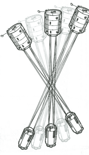

BTW, there are other configurations for artificial gravity that you may not have examined.
It doesn't have to be just one section the ship. Tie two sections of the ship with a cable and have them spin about their CoM.
The nice thing about this is that you can make the cable of arbitrary length - say, a few hundred metres (assuming it's strong enough) and then you can get a nice high g value while minimizing the Coriolis force.
This would only be practical if your journey were mostly straight line, and not much maneuvering. You'd have to reel it in for maneuvering.
You're right that a wheel shape is totally unnecessary. But how do you apply thrust to the setup you have pictured there?
Reeling it in will make the tangential velocity of the end-modules stupid fast, raising the g-forces on the cables to the point where they'll break, not to mention killing everybody. Reeling it in doesn't dump the angular momentum.
As I said, you don't.
But the OP started with "constant acceleration is impractical" so he doesn't plan on butterflying all over the neighborhood. Presumably a vast majority of the trip will be in a straight line.
Of course not. You can store the energy in a flywheel.
