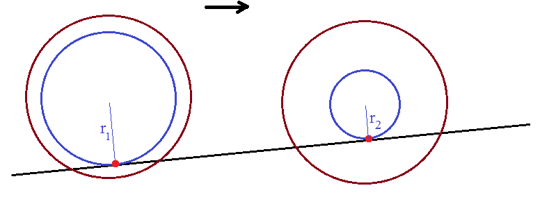

I assumed ω=v/r where the radius of rotation, r, decreases as the cone moves. r depends on d, R, and the angles α and β. I end up with a more complicated expression for v(d) that includes the angles α and β and the radius R. Did you derive an expression for r in terms of d, R, α and β?
I agree with your expression for L. L = R/[tan(α/2)*tan(β/2)]
I always thought that the radius R is the same as r. How can a body rotate with another radius r?
No I do not have a expressions for r. In school we did not learn that r is not R. Do you understand what I mean?
As shown in the picture, r decreases as the cone moves along the rails.
Thank you for the sketch.
r must be something like r=R-h-sin(y)*d with h as the difference of the height of the center of mass. But the conversation of energy is still right: m*g*h=1/2*m*v^2+1/2*I*w^2 and w=v/r and h=cos(y)*d*(tan(y)-tan(a/2)*tan(b/2))

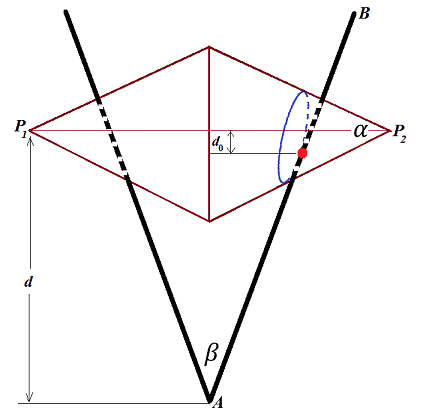

  • #34
Imagine a vertical plane that contains one of the rails. The plane will slice through the cone. The rail will contact the cone at the lowest point of the cross section. See the attached figure where you are looking at the cone along the axis connecting the apexes. For convenience, I drew the picture for the case where the plane of the rails is horizontal. The blue curve represents the cross section. The red dot shows the point of contact of the cone with the rail. You can see that the point of contact is offset from the apex by some distance ##d_0##.

  • #35
Okay that means if d>0, the lines do not cross each other orthogonally. And d is zero if the double cone rolled a round, considered from the point A, right?
  • #36
Yes, if you mean that line ##P_1P_2## is not orthogonal to the rail ##AB##. If this is not what you mean, can you specify the lines that you are talking about?
I'm not sure I understand this question. If you work out the "offset distance" ##d_0## as a function of ##d##, then I believe you will find that there must be some offset distance even at the starting point if you want the double-cone to rest on the rails at the starting point. So, the CM of the system would not actually be on a line through A and perpendicular to the plane of the rails at the starting point. Maybe this is what you are saying.

  • #37
I am talking about the line AB and the line through the center of mass and slice point from AB with the double cone.
Maybe this can be solved by vectors in the form
AB=(1,sin(y),tan(b/2)) Ocm(x,R+h,0) but I don not know how to describe OS, the slice point by the coordinate x of the center of mass.
With OS we could build the product AB*(Ocm-OS). The lines are orthogonal if this product is zero, isn't it?

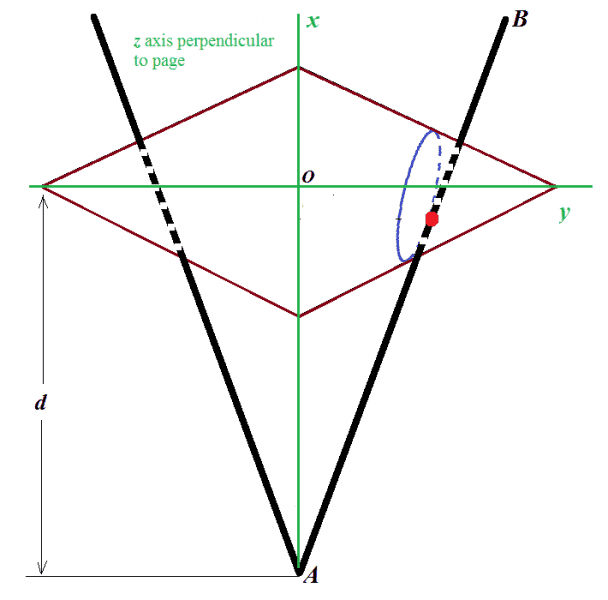

To find the point where one of the rails touches the cone, find the equation for the conic section created by the intersection of the cone with a vertical plane containing the rail. This requires writing an equation for the surface of the cone and an equation for the vertical plane. Use these to find the equation for the intersection. You can express these equations relative to your coordinate system where the origin is at the center of mass of the cone, the x-axis passes through origin and is parallel to plane of rails, the y-axis runs along the axis of the double cone, and the z-axis is perpendicular to the plane of the rails. See diagram.

  • #39
I failed at describing the double cone with vectors and finding an intersection equation. Could you help me?
  • #40

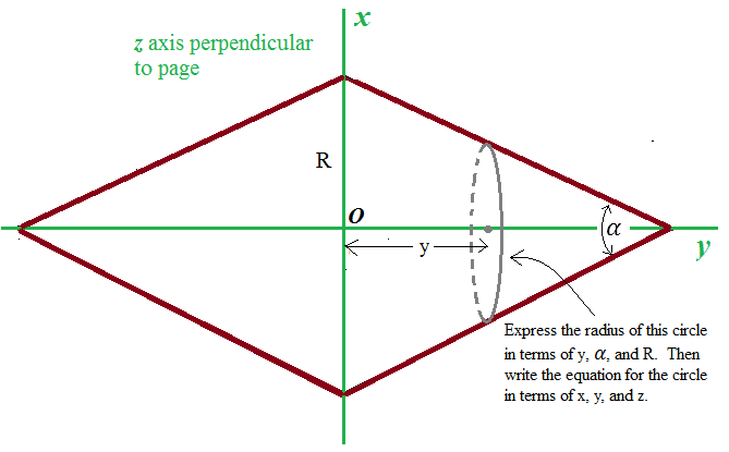

First find the equation for the cone in terms of the (x,y,z) coordinate system. Imagine the surface of the cone as made up of circular cross sections of varying radius.

  • #41
Sorry for answering so late.
Okay we imagine that the CM is the point CM=(xCM, 0 , R+xCM*(tan(y)-tan(b/2)*tan(a/2)).
Then the varying is dependent from the value of y. We can say: r=R-tan(a/2)*ycircle
The centre of the circle is (xCM , ycircle , R+xCM*(tan(y)-tan(b/2)*tan(a/2)). The circle is in the y-z-plane, therefore we have the circle equation: (y-ycircle)2+(z-( R+xCM*(tan(y)-tan(b/2)*tan(a/2))2=r2
Moreover the rails can be described by: AB=t*(1 , tan(b/2) , sin(y))
What should I do next?

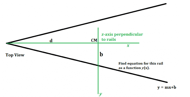

  • #42
When the cone is at a certain position, I found it easier to choose the axes relative to the cone as shown. The x-axis runs through the CM of the cone and parallel to the rails. The equation for the circular cross section is then just x2 + z2 = r2 where r is as given in your expression. You now have the equation for the surface of the cone in terms of x, y, and z.
Find an expression for the rail in the form y(x). This is also the equation for the plane that contains the rail and is parallel to the z axis. Use it in the equation for the cone so that you get a relation between x and z for the intersection of the the plane and the cone..

  • #43
Okay y(x) is supposed to be y(x)=tan(b/2)*x
And y(x)=ycircle Then we would have the equation:
(R-tan(a/2)*tan(b/2)*x)2=x2+z2
And z= root((R-tan(a/2)*tan(b/2)*x)2-x2)

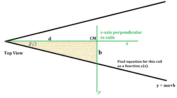

  • #44
The rail has a non-zero y-intercept in the chosen coordinate system.
  • #45
Is y(x)=tan(b/2)*x+R ?
  • #46
Not quite. y = tan(##\small\beta /2##) x + b where b is the y-intercept as shown.

  • #47
Thanks.
Are my next attempts right?
How do I solve this task?
  • #48
You have the right idea. Once you get the correct equation for intersection of the cone with the plane y = mx + b, you can then find the value of x that corresponds to the point where the cone touches the rail. Think about the value of dz/dx at this point.

  • #50
The equation for the cone is of the form ##x^2 + z^2 = r(y)^2##.
You already found the function ##r(y)## for the right hand side back in post #41.
The equation of the plane that passes through the rail and is parallel to the z -axis is of the from ##y = mx + b##.
You need to find the values of ##m## and ##b## for the right hand side. I believe you have already found the correct value for ##m## in post #45.
##b## is the y-intercept of the plane, where the y-axis is the axis of the cone that passes through the two apexes. You should be able to express ##b## in terms of ##\beta## and ##d##. See the shaded triangle in the figure.
