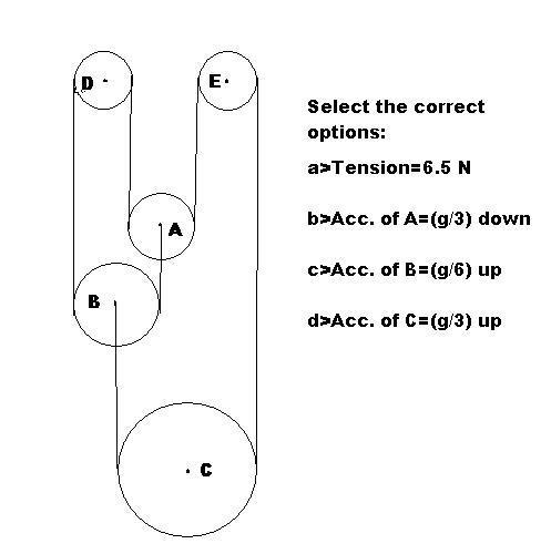

Awesome pulley problem!
Hey, i just came across this pulley problem and thought it was easy to solve...on solving, my answers were not matching...!
Check the attachment...
There is a single string. Ignore the friction.
The mass of the pulleys A, B & C is 1 Kg each.
*ignore the dirty, bad diagram...what else can i do in windows!?*
also post the method of doing...
correct options are a,b & d...

Your diagram is excellent- just enlarge it. Note that we do require that you show what you have tried yourself and you must try. To get you started, I would recommend you lable the ropes between pulleys (and the forces for each), say x,y,z,u,v,w. I count 6such ropes and so 6 such forces.

Is C fixed?
Have a think as to which are fixed, and (for the start) draw arrows on the diagram indicating which way the string will go.

i really [tex]don't[/tex] want to sound stupid but please do attach some points to the cieling(if any) otherwise the system will fall don due to gravity(if any )
anyways just use the fact that in a closed rigid system the tension(internal force) does no work.
since tension on each pulley is known spped hence accelaration of each pulley is known
There's an easy way for solving pulley problems, but I really don't know how to use that method.
make an equation using all ropes distances(find relationships between them), and differentiate them.
anyone knows that method?
yes the constrain t method but that's just mathematical representation of what u think intutively
for example consider the standard pulley problem of two masses say [tex]m_{1}[/tex] and [tex]m_{2}[/tex] hanging on two ends.
now say one get's down by [tex]x[/tex] other by [tex]y[/tex] then since rope length is constsnt we have
[tex]x+y=0[/tex]
differentiating
[tex]\frac{dx}{dt} + \frac{dy}{dt}=0[/tex]
thus [tex]v_{m_{1}}=-v_{m_{2}}[/tex]
differentiating again
[tex]a_{m_{1}}=-a_{m_{2}}[/tex]

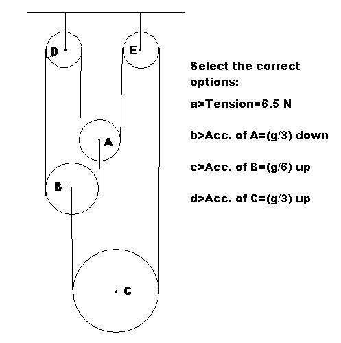

Um...correction...!
sorry for the wrong image...well, not wrong...but incomplete...!
The motion of pulleys or strings is not mentioned in the question...
