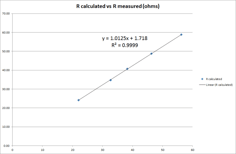

Have been busy working with a student doing a Physics prac to determine the internal resistance of an AA 1.5 V (nominal) battery. The basic formula being investigated is:
$$Vt=E_{cell}−Ir_i$$ where ##Vt## is the load (resistive only) voltage, ##E_{cell}## is the emf of the AA battery, ##I## is the circuit current and ##r_i## the internal resistance of the battery.
Practical problems we have had is that the terminal voltage seems to fluctuate continuously when you try to measure it. This can be mitigated somewhat by increasing the load resistance but then you start finding that the internal voltage drop is close to the limit of voltmeter resolution. R≈30Ω seems to be a reasonable value. That seems to be what is used on the "battery test" setting on my multimeter since the manual indicates an approximate current draw of 50 milli amps. (1.5 / 30).
However the specific issue I would like to ask advice on here is that I am consistently finding discrepancies between load resistance and the quotient of (measured) load volts over (measured) amps. The regression gradient is more or less unity as expected but there is a distinct offset value of nearly 2 ohms which I cannot explain. In terms of the determination of ##r_i## this is a problem since there is wide divergence between ##\Delta V## determined as ##E_{cell}-V_t## and as ##E_{cell}-IR##.
Here is my regression curve (R calculated vs R measured). Am using fixed value resistors but measuring anyway.

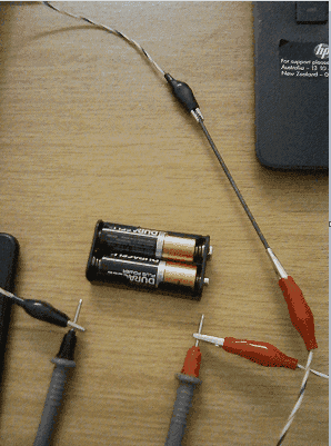

Regarding the fluctuating terminal voltage: what does your physical setup look like? Are you just trying to hold the multimeter probes to the ends of the battery with your hands? Is this something you could fix simply by throwing in some flying leads and alligator clips or banana plugs to connect to them, so that you could keep the DMM stable on the bench top?
I am using crocodile clips and I did carefully consider bad connections as a source of voltage fluctuations. Initially we planned to use low resistance values (< 10 ohms) but then it becomes almost impossible to measure load voltage since the large current draw is literally dropping the voltage (if not emf as well) as you watch.
Yes I am touching the probes to the battery by hand since one has to 'touch and release' otherwise the battery quickly gets hammered by the large current draw.
It's hard to know what's going on with your plot without understanding how you are arriving at R_calculated. Can you give us some more details on that?
The math can be expanded to
$$V_t = E_\mathrm{cell} - Ir_i = E_\mathrm{cell} - \left(\frac{E_\mathrm{cell}}{R+ri}\right)r_i$$
$$V_t = E_\mathrm{cell}\left(1 - \frac{r_i}{R+ri}\right)$$
if that helps.
I'm surprised to hear you say that the battery gets hammered when you connect the DMM. In voltmeter mode, a DMM should have a large input impedance, so that it doesn't place a big parasitic load on the circuit. It won't draw zero current, but it should not draw much. Are you connecting the DMM across the battery terminals, in parallel with the load resistor R? Sorry to question this, I mean no offence. Just thought it couldn't hurt to sanity check the basics.
The lead connecting to the load resistor is clipped onto the probe. So that the load only draws current when I touch the probe(s) onto the battery terminal(s). It's the low resistance load which is drawing heavy current - not the multimeter which has high impedance as you indicated.
R calculated is simply ##\frac{V_t}{I}## where ##V_t## is the measured load voltage and ##I## the measured load current.
My best guess is non-negligible series resistance in the circuit, even when R = 0.

With the setup as shown above, I can first measure resistance. Since the leads (and probe leads) are part of the circuit, they should automatically be included within the measurement although (hopefully) they have negligible resistance anyway.

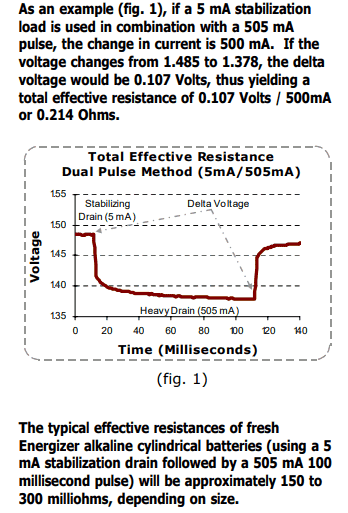

This is a basic school Science prac. I'm aware of more complex circuit models for typical AA cell batteries.
http://mocha-java.uccs.edu/ECE5710/ECE5710-Notes02.pdf
But we do not want to do much more than measure the voltage drop under load and divide by current to obtain an estimate of internal resistance. Therefore the aim is to try and provide experimental conditions under which internal resistance is the dominant cell parameter (*) and holds more or less constant. Internal heating of the cell due to heavy current draw is probably not ideal in that respect which is why I advised my student to use higher resistance values than advised in the prac sheet (4 ohms).
(*) I take the point that this is a variable rather than a parameter but that's why we're trying to find conditions under which it is constant.

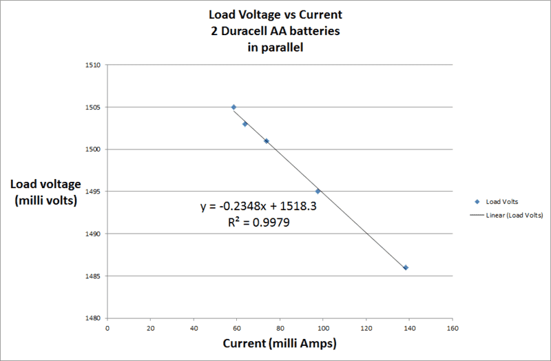

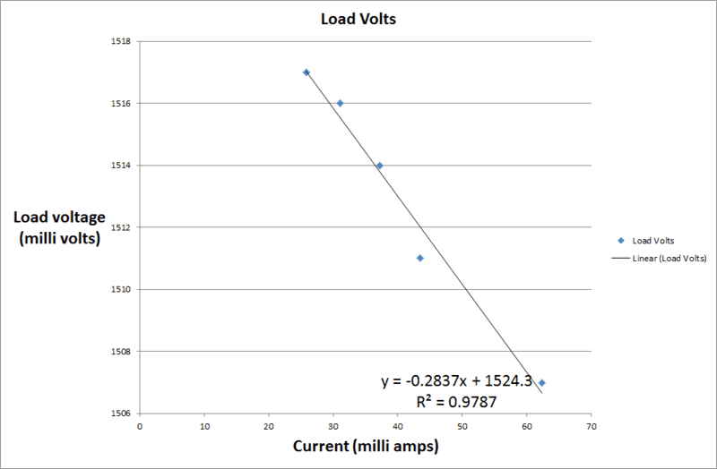

One can also plot load volts vs current whereby the gradient is the negative of internal resistance and the y-intercept is emf. Graph follows - it is not too bad but I hoped for a better correlation coefficient and an emf (open circuit voltage) value closer to that measured.

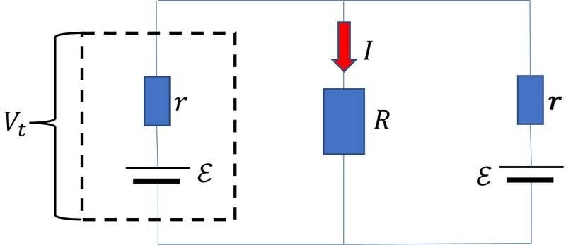

Are the batteries connected in series or parallel? In the picture, the batteries appear to be in the same orientation, on what I think looks like opposite terminals. Is there a fixed resistance in the battery circuit component?

Are the batteries connected in series or parallel? Is there a fixed resistance in the battery circuit component?
Just spit balling ideas. If they are goofy feel free to laugh.
Thanks. All ideas welcome! I'm trying two AA cells in parallel using what would normally be a serial connection battery holder. And connecting the positives with another crocodile clip lead. The regression trendline per my graph above gives ##r_i\approx 0.28 \Omega## and I think that is about right because a single AA shows ##r_i \approx 0.63 \Omega.##
There's no fixed resistance in the battery holder that I'm aware of unless there's some resistance introduced when I put the probes onto the + and - terminals.
Does the fact that each of the batteries are only ( theoretically perfectly matching ##\mathcal{E}## ) delivering half the measured load current do anything?
I think the relation would be?
$$ V_t = \mathcal{E} - \frac{I}{2} r $$

What am I doing wrong?

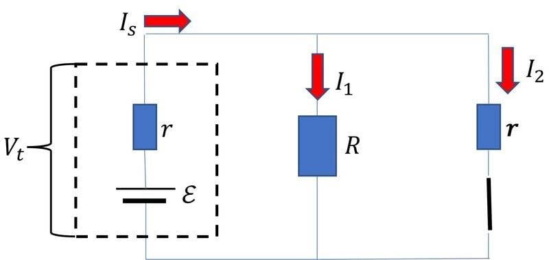

Using the principal of superposition, one of the sources is replaced with a short circuit equivalent
After combining ##R## and ##r## and applying Kirchoff's Voltage Law:
$$ \mathcal{E} - I_s r - I_s \frac{Rr}{R+r} = 0 \tag{1} $$
Which implies:
$$I_s = \frac{R+r}{r^2+2Rr}\mathcal{E} \tag{2} $$
To determine the current passing through the load ##R## from source 1:
$$I_s = I_1 + I_2 \tag{3}$$
We also have that:
$$ I_1 R = I_2 r \implies I_2 = I_1 \frac{R}{r} \tag{4} $$
Substituting ##(4) \to (3)##:
$$ I_1 = \frac{r}{R+r} I_s \tag{5}$$
Substitute ##(5) \to (2)##:
$$ I_1 = \frac{R+r}{r^2+2Rr} \mathcal{E} \frac{r}{R+r} \tag{6} $$
We repeat the process for the other source and add the results. In this case we find that what we measure as the load current ##I = 2 I_1##
$$ I = \frac{2r}{r^2 + 2 R r} \mathcal{E} \tag{7}$$
So to get the value for ##r##, we have ##\mathcal{E}, I, R## and solve ##(7)##:
$$ I r^2 + 2 \left( IR - \mathcal{E} \right) r = 0 $$$$\implies r = 2 \left( \frac{\mathcal{E}}{I} - R \right) $$

My thinking is that two batteries in parallel have an equivalent circuit (assuming the simple resistive cell model) of a single emf and half the resistance - also assuming both have the same internal resistance.
