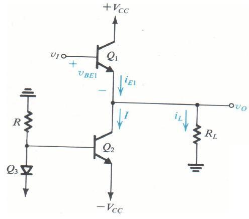

i see biasing often done with current sources usually at the emitter of the npn. is there a way to easily choose this bias current to design for a specific transfer function with respect to changing input voltage, or does it require a small signal model and calculating the overall gain and manipulating impedance for pole/zero?
The gain of an amplifier is not normally set by the bias current. It is a function of the characteristics of the transistor (which you have little control over) and the load resistance.
The bias current is usually dictated by these factors.
For example, if the load resistor has already been chosen, the bias current is selected to give a collector to emitter voltage of about half of the supply voltage. This way, the output voltage can swing equally in each direction.
I don't think I have seen this. Could you give an example?
ex this amplifier which is biased by I from Q2.
Yes, I have seen that circuit, but it is very rarely used.
Usually a resistor works OK.
That's certainly true for discrete circuits, where resistors are usually cheaper than transistors, and possibly more reliable.
By contrast, current source biasing is more commonly used within Integrated Circuits. This is partly because moderate to large value integrated resistors are relatively bulky compared to transistors. It is also possible to obtain a number of related bias currents by a technique called current mirroring, which can allow useful features like adjustable speed/power trade-offs.
This circuit is really more of a substitute load than a biasing component.
You still have to arrange biasing to Q1's base.
