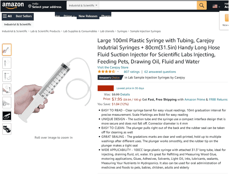

Maybe something like a 100mL syringe (no needle) with a cap?
Amazon product page for a 100ml plastic syringe with a long clear tube, held in a hand; graduation markings on the barrel and a tubing attached to the tip.
https://www.amazon.com/dp/B07DXS7ZTV/?tag=pfamazon01-20
Thanks for the replies. To answer berkeman's questions:
The pouch will be compressed by a pressurized gas and a valve will be used to release small amounts at a time. This will be done automatically so no one is handling it and it will be in a sealed container. Refilling will take place through a series of valves so again no one has to handle the bag once it is sealed in the pressurized container.
