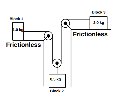

The diagram shows a block and pulley
system where all the surfaces are
frictionless, and all the pulleys are
massless and frictionless.
Express the magnitude of the acceleration of Block 2, a2, in terms of a1 and/or a3.
F=ma
FBD for block 1
m1 * a1 = T
a1 = T
fbd for block2
m2 * a2 = 2T - m2*g
a2 = [2(a1) -m2*g]/m2
a2 = a1 - g
But i am wrong for some reason..
It looks like the answer is a2=3/2 * a3 or 3/4*a1
Any help would be awesome
Any ideas
The answer is a2=3/2 * a3 or 3/4*a1 which is the solution, I'm not sure how that was achieved.
a2 = a1 - g
Hi NoobeAtPhysics. There is a bit of mind reading involved, but you haven't got to the intended answer only because you have expressed a2 in terms of a1 and g. You are to find it in terms of a1 alone.
There is a relationship you have overlooked, viz., the linking rope dictates that the motion of block 2 is tightly tied (no pun intended :smile:)[/color] to the motions of blocks 1 and 3.
The speed of descent of 2 is the average of the speeds of 1 and 3. The distance through which 2 descends is the average of the distances moved by 1 and 3. Likewise, the magnitude of the acceleration of 2 is related to the accelerations of 1 and 3...

The first step is to establish the kinematics of the motion. Suppose mass 3 is held fixed, and mass 1 moves to the right by 1 unit. How much does mass 2 move downward? Then, suppose that mass 1 is subsequently held fixed, and mass 3 moves to the left by 1 unit. How much does mass 2 move downward? From this, you should be able to conclude that a2=(a1+a3)/2.
