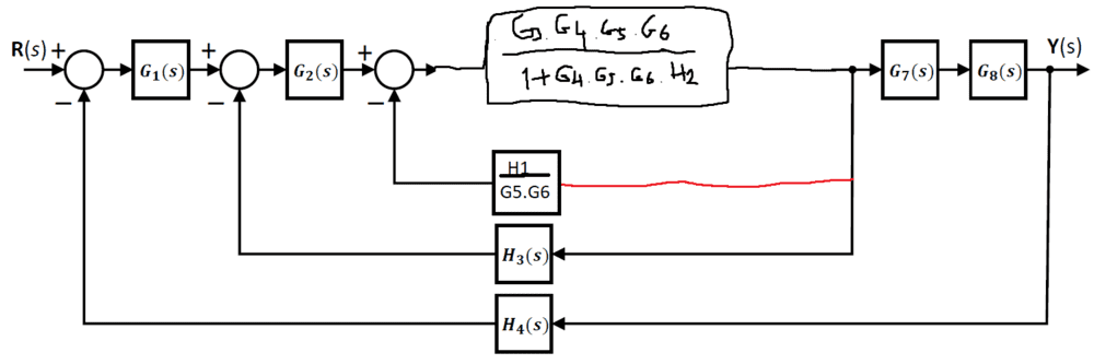

Reduce the block diagram to the canonical form:
Am I moving right? I am not sure. Do you have any idea how should I do?
Block diagram of a position-control system with a sensor K_s, preamp K, power amplifier K_1 and 1/(R_a + L_a s), torque gain K_t, 1/(J_s s + B_t) load, 1/s and gear ratio N, plus back-EMF K_b, current feedback K_2 and tachometer feedback K_t.
Hand-annotated control system block diagram: R(s) enters a summing junction, then G1(s), G2(s), a third summing junction, and a block labelled G3.G4.G5.G6 over 1 + G4.G5.G6.H2, then G7(s), G8(s), output Y(s). Feedback paths include H3(s), H4(s) and H1 over G5.G6.
You are on the right track.
You are now left with three feedback loops in the diagram. Reduce them one by one, starting from the rightmost summing point.
