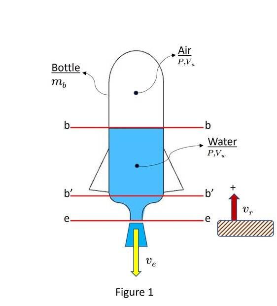

I've been trying to model a bottle rocket (water propellant, compressed air fuel) and my model seems ok for a typical 2L soda bottle type dimension, but when I decrease the radius of the nozzle, I expect there to be a "maximum altitude" and then a decrease to "no altitude" for some small radius, but the model is showing otherwise. I can see that the velocity of the propellant goes right through the speed of sound as I decrease the nozzle radius, and I think this is the problem. I was hoping the shear force in the nozzle would prevent this issue, but it isn't doing the job. Below is the model (its a bit involved). I've tried to make sure I've explained it, but If I miss things, please let me know (that's why I'm posting it).
Figure 1 is the initial setup:
Initially there is some volume of air ## {V\llap{-}}_a## at a pressure ## P_o ## (gauge pressure). The volume of propellant ( water ) is ## { V\llap{-} }_w ## . Then at ## t = 0 ## the rocket is released. The velocity of the rocket ## v_r ## is w.r.t. a stationary frame fixed to the ground, and ## v_e ## is the velocity of the jet w.r.t. the rocket.
Figure 2 is the Free Body Diagram of the external forces acting on the rocket.
Section 1 - Applying Newton 2nd Law:
Assuming:
the weight of the air compressed air is negligible.
The fluid jet exits at ## P_{atm} ## (valid for fluid jet velocity that is less than the local speed of sound in the fluid)
$$ M_r \frac{d v_r}{dt} = -\dot{M} v_e - M_r g - \frac{1}{2} \rho_a A_b C_D v_r^2 $$
From here change independent variable from time ## t ## to mass of the propellant ##M## by noticing that:
$$ M_r = M + m_b \implies \dot{M_r} = \dot{M} = - \rho A_e v_e $$
Applying the Chain Rule:
$$ - M_r \rho A_e v_e \frac{d v_r}{d M_r} = \rho A_e v_e^2 - M_r g - \frac{1}{2} \rho_a A_b C_D v_r^2 \tag{1} $$

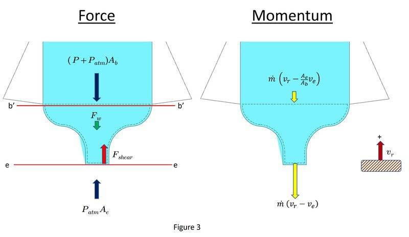

Section 2- ## v_e ## of Propellant:
Figure 3 shows a Force and Momentum diagram applied to the control volume shown by the dashed boundary.
From the Reynolds Transport Theorem
$$ \sum F = \frac{d}{dt} \int_{cv} \rho \mathbf{v} dV\llap{-} + \int_{cs} \mathbf{v} \rho \mathbf{V} \cdot d \mathbf{A} $$
Assuming:
Uniform velocity across sections b'-b' and e-e
Continuity
The fluid in the control volume is incompressible $$ \sum F = m_{cv} \frac{d v_r}{dt} + \dot{m} v_{ee} - \dot{m} v_{b'b'} $$
Furthermore the mass in the control volume can basically be taken to be very small and I neglected the accumulation term.
$$ \sum F = \dot{m} \left( v_r - v_e \right) - \dot{m} \left( v_r - \frac{A_e}{A_b} v_e \right) $$
or substituting for ## \dot{m} ##
$$ \sum F = \rho A_e \left( \frac{A_e}{A_b} - 1 \right) v_e^2 $$
Force Balance:
Assuming:
Weight of mass in the control volume is negligible
Pressure in section b-b is equal to b'-b'
- No pressure loss from viscous effects in this section
- No pressure increase from hydrostatic pressure in the column
- No pressure increases from inertial forces associated with ## \frac{dv_r}{dt} ##

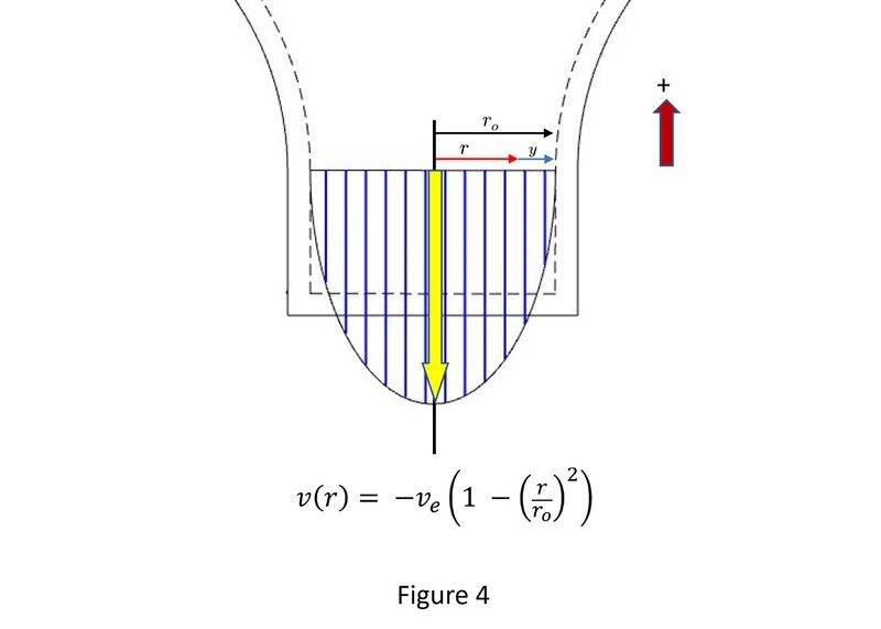

$$ \sum F = P_{atm} A_e - \left( P + P_{atm} \right) A_b - \pi D l \mu \left. \frac{dv}{dy} \right|_{r_o} $$
The last term on the right is the shear force, and the minus sign comes from the sign convention ( I think it correct ).
To get a functional slope ## \frac{dV}{dy}## at the boundary I had to assume a parabolic velocity distribution. *I'm aware that this somewhat contradicts an earlier assumption in applying the Reynolds Transport Theorem where I assumed uniform velocity distribution across the nozzle ( section e-e ).
Figure 4 shows this distribution.
from this we have that:
$$ \left. \frac{dv}{dr} \right|_{r_o} = 2 v_e \implies \left. \frac{dv}{dy} \right|_{r_o} = -2 v_e $$
Substiting that result back in:
$$ \sum F = P_{atm} A_e - \left( P + P_{atm} \right) A_b + 4 \pi l \mu r_e v_e $$
