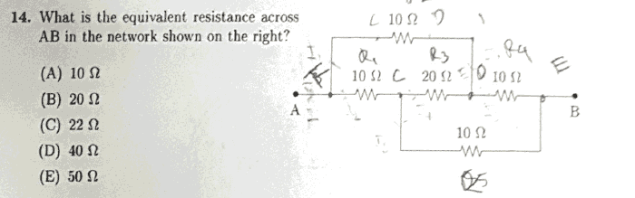

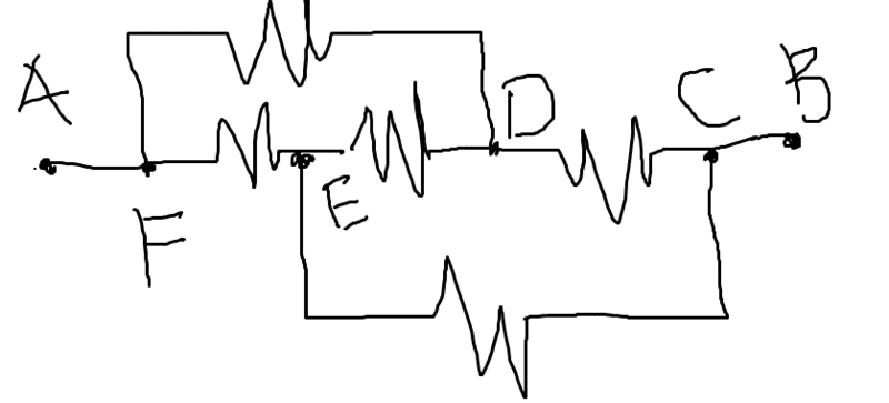

I tried to break it down to:
But apparently it is incorrect, can someone tell me the correct configuration? And explain too! Thanks :)
(Please do not give ambiguous "hints").

Oh nevermind just realized this is is a wheatstone bridge, silly me

LOL. How about an unambiguous hint? Like using KCL equations to solve it. There may be a trick that you can use, but if you don't see the trick pretty quickly, just doing the KCL equations and solving should get you the answer. And for a circuit this simple, The KCL equations are fairly easy.

What makes you say that your rearrangement is wrong? The only problem I can see would be if you incorrectly locate the 20 Ω resistor on the figure (you didn't label any of the the resistors, so I can't be 100% sure that you've got that right).
Edit: Just saw the OP's latest post, correctly identifying the circuit configuration. So never mind :smile:
