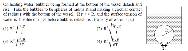

Pressure inside bubble = 2T/R
Buoyant force on bubble = ##\frac{4}{3} \pi R^3 ρ_w g ##
But I do not understand how surface tension is exerting force on the bubble .Also I do not understand the direction of surface tension force .
Please help me with the problem .
Thanks

At the contact with the base, surface tension acts tangentially to the bubble surface and perpendicularly to the line of contact (i.e. to the tangent to the circle of contact). Consider vertical force components.

The surface tension should result in a force on the base of the bubble, pulling it down onto the base of the vessel. On any short section of the circle of contact, the tension should act tangentially to the bubble, not straight down. We want the integral of the force around the circle. By symmetry, only the vertical component of the force on any short section will be left uncancelled, so we can take that vertical component and simply multiply it by the circumference of the circle.
However, I am not able to arrive at any of the offered answers. I have started a thread in the Advisors' forum to see if anyone else has ideas.
Likes Delta2 and Vibhor
Here's what I posted on the Advisors' forum:
The buoyant force of the water on the bubble will not be ##\frac 43\pi R^3\rho g## because there is no water under the (almost) sphere. It will fall short by ##P_w\pi r^2##, where ##P_w## is the pressure in the water at the base of the vessel.
Correspondingly, the gas pressure should exert a net upward force on the bubble of ##P_g\pi r^2##, where ##P_g## is the pressure of the gas.
The two pressures should be related by ##P_g=P_w+\frac {2T}R##, but that's taking the pressure in the water to be uniform around the bubble, which cannot be true for Archimedes principle to work. So I correct this to take the water pressure around the bubble as averaging ##P_w-R\rho g##. I.e. ##P_g=P_w-R\rho g+\frac {2T}R##
Finally, I take the surface tension along the contact with the base of the vessel as the force holding the bubble down. Allowing for the presumed angle of contact (taking the bubble to be a sphere with a cap removed), the net force from this is ##2\pi rT\frac rR##.
Pulling all this together, I find T disappears leaving ##r=R\sqrt{\frac 23}##.
Throwing all that away and crudely writing ##\frac 43\pi R^3\rho g=2\pi rT\frac rR## I do not get any of the offered answers. I would get one of them if I used ##4\pi rT\frac rR##, as would be appropriate for a bubble out of water (so double shelled).
I got a response from TSny, a contributor for whom I have the utmost respect. He agrees with my analysis.

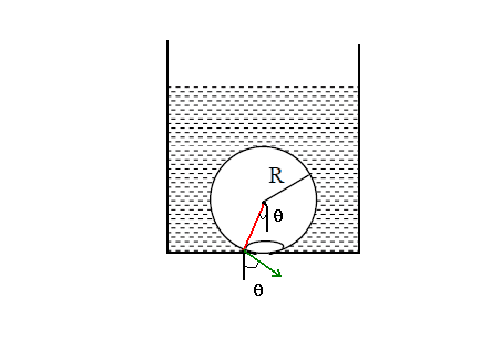

Please see the attached image . Do you agree that green vector correctly shows the direction of surface tension acting on the bubble along the circumference of circular part of the bubble in contact with the vessel ?

The surface tension force is due to the flat circular part of the bubble on the large spherical part . Isn't this an internal force as far as complete sphere is concerned ? How can we consider this force while doing the force balance on the sphere ? In other words , how can an internal force pull down the bubble ?

Yes, you have the vector correctly.
There is no flat circular part to the bubble wall. On that area, the gas is in direct contact with the dry base of the vessel.
I agree you have to be consistent as to what is considered the "free body". You can take it to be the wall of the bubble (i.e. the layer of liquid in contact with gas) or that plus the gas. You should get the same result either way. I chose wall+gas.
The surface tension does two things. Over the general spherical curve of the bubble wall, it is an internal force of the wall+gas but leads to the pressure difference between gas and surrounding liquid. This pressure difference does act on the wall+gas over the circular dry area.
It also pulls directly on the vessel base around the perimeter of the circle.
