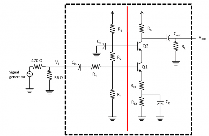

Hi everyone. I have seen the design for an NPN Cascode many times, but I want to build a PNP Cascode. I have scoured the internet for a standard design, but to no avail.
The image below is that of a NPN Cascode. I want to create a PNP cascode by flipping things around. I have placed a red line through the circuitry. On the left side of the red line I expect nothing to change when building the PNP Cascode. On the right side of the red line is where I expect things to change.
Here is what I am thinking:
1. I will turn transistors ##Q_1## and ##Q_2## into PNP transistors.
2. In the emitter of ##Q_2## there will be no resistor, only the power supply connection ##V_{CC}##.
3. Between the collector of ##Q_2## and the emitter of ##Q_1##, I will place ##R_C## just before the loading circuit. Then I will place the loading circuit.
4. Just after the loading circuit, I will place ##R_{E1}##, ##R_{E2}## and ##C_E##.
5. The collector of ##Q_1## will then be wired to ground.
Does this sound reasonable?
If not, does anyone know what the standard design would look like and could show me?
Thank you.

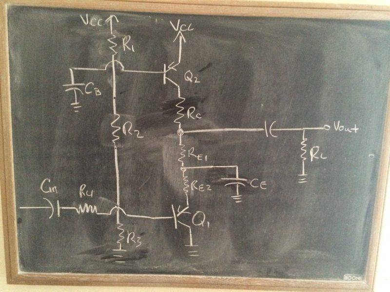

I took the time to make a quick blackboard sketch of what I thought it looks like:
Seem reasonable?
Your PNP version is wrong, and will not work. The Cascode is CE stage + CB stage.
The correct circuit look like this

I drew this:
https://gyazo.com/d3cfd6526d94f4ce09a6ab1885debf01
It looks pretty much like yours, except the capacitor ##C_E## should be grounded.
Zondrina said:
Almost right. R3 resistor must be connected to VCC and R1 to GND.
To convert any NPN circuit into PNP version simply amply this rules:
1 - Change transistor type NPN into PNP
2 - NPN ground now becomes PNP VCC
3 - NPN VCC change to PNP GND (simply reverse the power supply polarity).
4 - If necessary reverse electrolytic capacitor polarity
But this change is not necessary (Vcc is also a good place).
