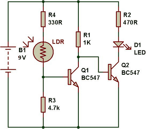

Hello,
I have this circuit:
And I'm using this battery: http://www.tme.eu/en/details/bat-6f22_gp/batteries/gp/gp-1604g/#
How long will the battery keep supplying the circuit?
Thanks !

Got data on the LDR? I suppose in bright light the resistance might be as low as say 470R. In which case
In the daytime the current will be roughly..
Iday = (9-Vbe)/(R4+LDR) + (9-Vcesat)/R1
= (8.3)/(330+470) + (9-0.3)/1k
= 10mA + 9mA
Call it 20mA
At night the current will be roughly..
Assume LRD has very high resistance so negligible current.
Inight = (9-Vbe)/R1 + (9-Vled-Vsat)/R2
= 8.3/1k + (≈6V)/470
= 8.3mA + 12mA
Call it 20mA
So average consumption is around 20mA.

It includes a graph showing how the voltage will fall with time when used with a 620 Ohm load. Now 620 Ohms would draw about 9/620 = 15mA which is less than your load.
I think you will be disappointed. It suggests that at 15mA the voltage will be down to around 6V in 20 hours.
PS: You would get longer battery life if you left the LED on all the time and simplified the circuit so you just had the LED and a 470R.

As it stands, it is not a very efficient circuit for battery operation. What purpose will the LED serve? Quite likely it could be run much dimmer while still being just as visible. You want to light the LED for the entire 12 or so hours that the sky is dark? A blinking LED could use 90% less current, but may do the job equally well, maybe giving even better visibility.
I think that's the place to start... What's the purpose of the LED? Is it to light up an area of ground with a given brightness or ??
You may have to show your brother what several different LEDs look like if he's not able to specify the brightness required in scientific terms. Find out what is the lowest level of illumination he can accept.

If you want to use these with a 12V car battery...
http://www.superbrightleds.com/more...30-degree-viewing-angle-400-nm-40mw/630/1905/
They are rated at 30mA continuous. The forward voltage drop is typically 3.5V so you could just put two in series with a 180R resistor. eg so it's on all the time. The current draw would be around..
(12 - 7)/180 = 28mA
There are lots of 12V Scooter, motorbike and car batteries come in a range of capacities. See if you can find one in the range 10-20AH. You might find a car breakers yard prepared to give you a few old batteries to experiment with for free.
In theory a new 20AH should power it for a 20/28E-3 = 700 hours = 29 days.
However lead acid batteries don't like being fully discharged so I would aim to recharge it say once a week.
