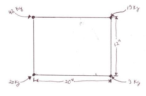

The attached jpeg shows a force plate with four measured masses each corresponding to a corner node. Calculate the center of mass on the force plate.
I think they would be:
xcg = (x1M1 + x2M2 + x2M3 + x4M4) / (M1 + M2 + M3 + M4)
The ycg would be the same except you put yn in for xn.
The textbook I've seen will place the lower left node at (0,0), thus zeroing out two of the nodes in each calculation. How does this give an accurate answer?
So for this method, the xcg would be:
xcg = (19*20 + 9*20) / (20 + 42 + 9 + 19)
Is this correct?
They are just choosing a reference point for describing the coordinates. They chose the origin to be at the lower left. No problem--it doesn't change where the center of mass is, just how you describe it.
Is this correct?
Sure. Why not? Note that this is consistent with the formula you gave.
