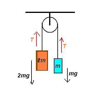

a load of bricks of mass m hangs from one end of a rope that passes over a small frictionless pulley. a counterweight, twice as heavy, is suspended from the other end of the rope. given m determine the accel of the masses and the tension in the rope
f=ma
Fa=-2mg + T
2m*a=-2mg + T
a= (-2mg+T)/2m
plug in accel in other force
Fb = -mg + T
m((-2mg+T)/2m) = -mg + T
-2mg + T = -2mg + 2T
T = 2T
T=0?
i have no idea if I am doing anything remotely close to the right path, if I'm way off please explain like a baby as I'm confused thanks for help

FFrom your calculation for Fa, T is greater than 2mg, so it is going up.
When one side going up, the other side should be going down.
But for calculation for Fb, T is greater than mg. It means going up, where you have assumed that it should be going down.
It is a single cable.
m(a-g)+T= 2mg-T
ma= 3mg-2T
a=(3g-2(T/m))
this is the acceleration of the mass?
You would understand the problem better with a drawing showing the forces on both objects, brick and counterweight, as in the attachment.
In what direction will the brick and counterweight move? What is the net force acting on the brick? What is the net force acting on the counterweight?
How are the accelerations related?

so since pulley requires each to go in opposite direction you make one force negative relative to coordinate system:
(using fa from above)
fb = -mg + T
-ma = -mg + T
T = 4/3mg?
T=4/3 mg is correct.
