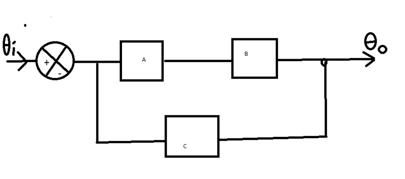

1. Write down expression for the open-loop , loop , closed loop gains of the system shown in below , in term of the stage gains A,B,C .
Here is my work .
a)
Open Loop gain = A x B
Loop gain = A x B x C
Closed Loop gain = θo/θi = A x B x C / (1+(A x B) x C)b) The table below gives the magnitude and phase angle of the stage gains of the system represented by block diagram shown in below . Magnitude of gain Phase angle
Controller A 0.5 13°
Process B 2 113°
Measuring System C 0.5 47°- Determine if the system is stable ?
here is my work ,
= 0.5 x 2 x 0.5
= 0.5
As the loop gain of a system is less than unity , this is stable system.
- Determine the new value of controller gain that will cause the system output oscillate with constant amplitude.
Controller gain x 2 x 0.5 = 1
Controller gain = 1/2 x 0.5 = 1
Could you please check this out for me , as I'm not confidence these are the right answer. Thank you
