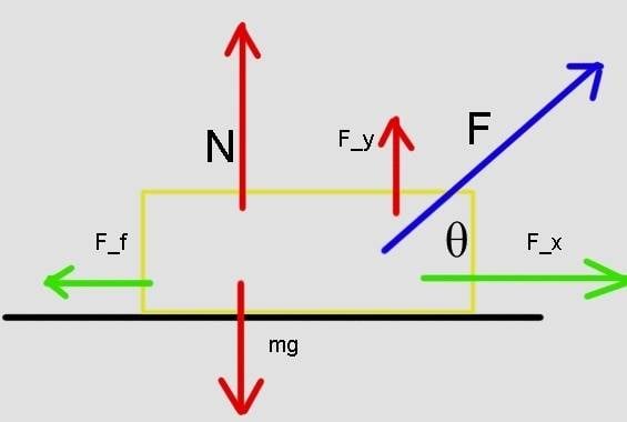

Hi guys,
I got this thought in my head.
If I have a box of mass x, being pulled towards East and the angle [tex]\theta[/tex],
then force applied to the box in order to move it on the surface with friction coefficient [tex]\mu[/tex] has to be in such a way:
Inequality F_x ≥ μN, where F_x = F cos θ, written in vector notation with arrows over F_x, F and N.
My question is... wouldn't N be:
Equation: N = m g - F_y = m g - F sin θ, with vector arrows over N, g and F.
Or, N would be as usual W but in opposite direction? The drawing shows all the forces on the box:
Cheers and thanks for the thought
Free-body diagram of a box on a horizontal surface with forces N up, mg down, F_f left, F_x right, F_y up, and an applied force F at angle θ.
  • Inequality F_x ≥ μN, where F_x = F cos θ, written as vector-marked symbols for a box pulled at an angle.
  • Free-body diagram of a box on a horizontal surface with normal force N up, weight mg down, friction F_f to the left, and applied force F at angle θ split into components F_y up and F_x to the right.
  • Equation: N = m g - F_y = m g - F sin θ, with vector arrows over N, g and F, and F_y as the vertical component of F.
Equation: N = m g - F_y = m g - F sin θ, with vectors over N, g and F, and F_y written as a vector component.
You got it.
Nope. You were right the first time. The key is that there must be no net force on the box in the vertical direction.
