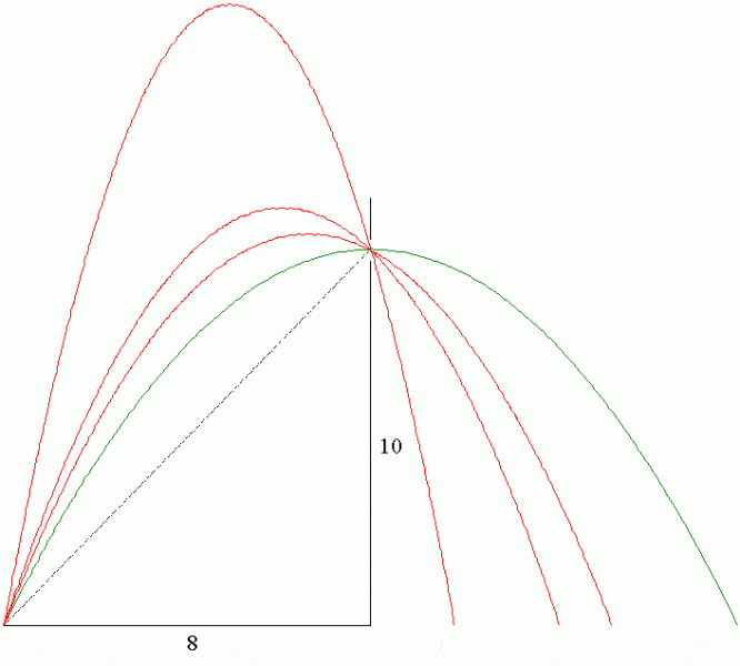

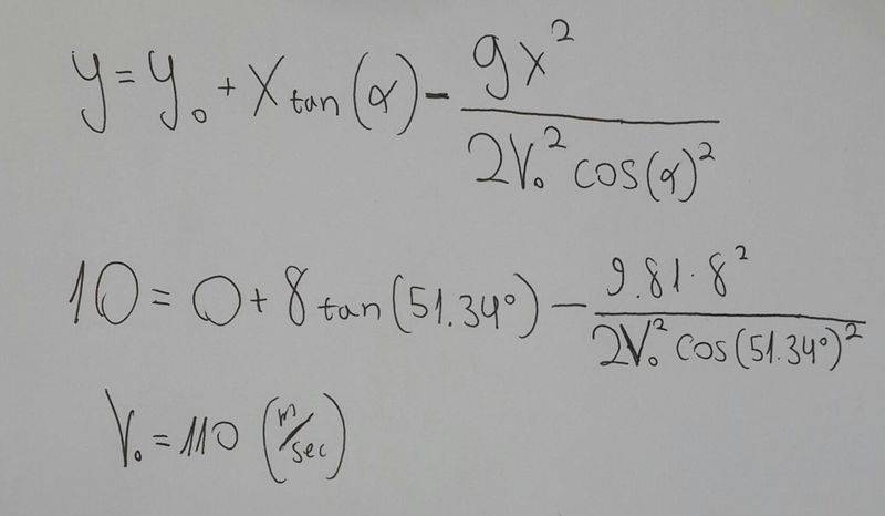

A cannon has to fire a ball through a window in the wall. The window is 10 meters at the Y axis, and 8 meters (away from the cannon) at the X axis. The window is just slightly bigger than the ball (let's suppose that the dimensions are negligible). Find the required launching power.
Ball's mass: 0.6 kilograms
Angle of launch: 51.34 degrees
I seem to be getting a strange initial velocity, way too high. Is my formula off? Or calculations?
Well,in your formula..,your ##g## should be ##g= -9.8 units ##.
Could you check your arithmetic again. And I hope you know how to do the rest of the question, though you have not posted it.
No, the lady is doing just fine. It takes a bit of sleuthing to track what you are doing, but it's correct.
Cannons can get huge muzzle speeds nowadays. It's not like they are throwing a stone or a ball...
However, a straight line to the window has slope 10/8 and atan(10/8) = 51.3402##^\circ##
And then the expression 10 - 8*tan gives zero !
In other words, muzzle speed has to be infinite.
That you get a finite result could well be due to rounding in the calculator.
Then: If the window is only slightly bigger than the cannonball, you'll have to lift the cannon 10 m up, or else the ball won't get through :wink:

What is the arc-tangent of 10/8 ?
There are any number of parabolic trajectories that can originate at the canon and reach the window. Given the tight fit, I suppose the trick is to choose one that happens to be traveling horizontally at the moment it passes though the window...
So where does the given firing angle come from ? Femme or problem statement ?
It looks to be based upon the assumption of a straight-line trajectory from canon to window (not feasible with gravity acting). With a high enough initial velocity one could approach that goal if the window opening allows the ball to pass through at such an angle. Then it would be a matter of checking tolerances for such a scenario, but we don't have specifics.
