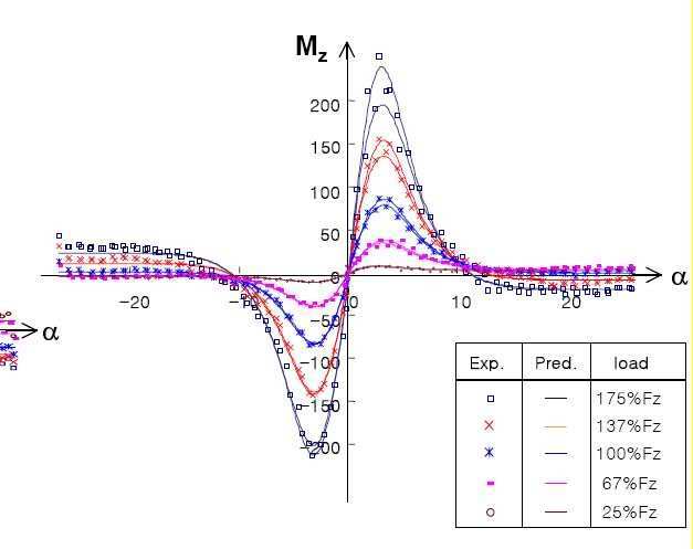

I tried to calculate the minimum force needed to apply on the knuckle to make a turn.
The important factor is the normal load (due to the weight of the vehicle) when the vehicle is not moving. I know the kingpin angle, scrub radius, knuckle arm, caster. But I am not sure how to proceed forward. Any help will be appreciated.
Look for self-aligning torque:
