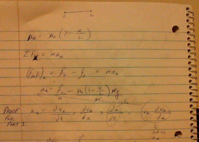

Ruinmaniac said:
I know that vx = dx/dt,
... and ax = dvx/dt.
What do you get if you combine the two equations so as to eliminate dt?
Note that if you integrate the target equation and multiply both sides by the mass you will get a conservation of energy equation. You can use this to answer the question.

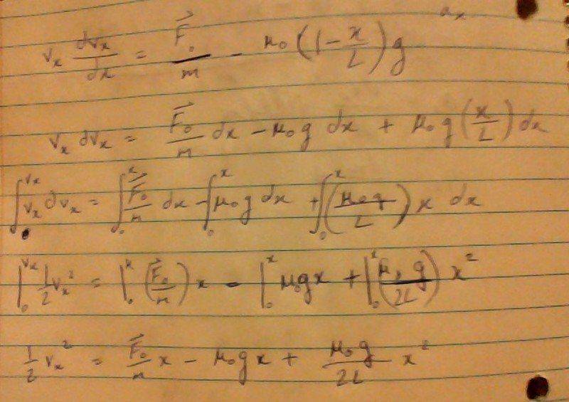

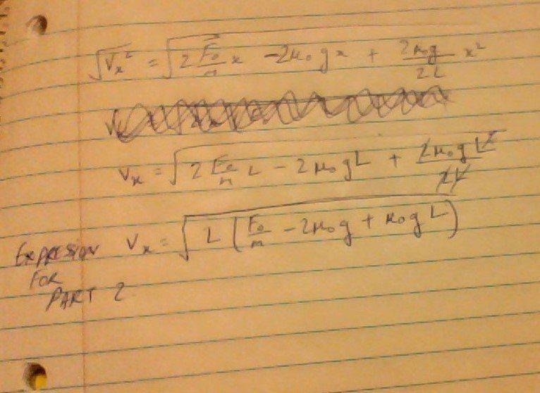

Thanks, I think I got it. Sorry for the bad quality photos, my webcam is the only camera I have when doing late night physics :P

Can you tell me if my final answer is right? There is no answer for this question in the textbook. The true final answer (after that factoring error I have) is:
vx = root(L(Fo/m - uog))
