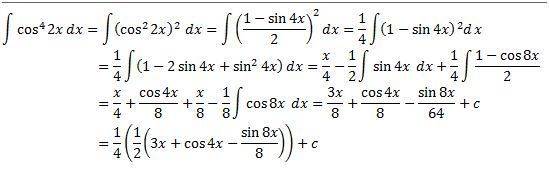

Apparently I'm doing something wrong. I'm kind of lost as to what because I looked over my work several times.
sin^2 x = ( 1 - cos 2x )/2
cos^2 x = ( 1 - sin 2x )/2
integral sin(x) dx = -cos(x)
integral cos(x) dx = sin(x)
SEE ATTACHMENT
Wolfram Alpha says the correct solution is 1/64 (24 x+8 sin(4 x)+sin(8 x))+constant
Thanks for any help you can provide!
The bolded is not right. It should be
[tex]\cos^2 x = \frac{1 + \cos 2x}{2}[/tex]

So i guess there's a plus sign and I forgot to include it becuase i used minus instead
cos^2 x = ( 1 + sin 2x )/2
cos^2 x = ( 1 + sin 2x )/2 instead of cos^2 x = ( 1 - sin 2x )/2
That is one mistake in my work... assuming that formula is right
oh man I am an idiot thanks

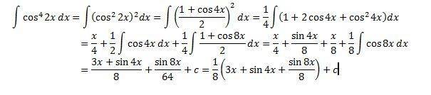

I guess I'm still doing something wrong, don't know what though

cos^2(x) = 1/2(1 + cos(2x))
Ya I know. I still don't see what I did wrong though in post #7
It's actually the same as the answer you got from Wolfram. You just need to factor out another 1/8.
[itex]\frac{1}{8}\left( 3x + \sin 4x + \frac{\sin 8x}{8}\right) + C[/itex]
[itex]= \frac{1}{8}\left( \frac{24x}{8} + \frac{8\sin 4x}{8} + \frac{\sin 8x}{8}\right) + C[/itex]
Do you see it now?
The answers don't seem to match though for some reason and I don't have a clue as to what I'm doing wrong...
The answer I got was
1/8 [ 3x + sin(4x) + sin(8x)/8 ]+ c

WA gave me 1/64(24x + 8sin(4x) + sin(8x)) + constant, which is equivalent to the answer you say you got above.
For the other answer that you say WA gave you, I took its derivative in WA and it gave sin4x, so it looks like you had a mistake when you entered it in.
huh weird thanks
