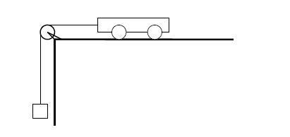

A Hot Wheels car, whose mass is 200g is hauling a mass block of 150g along a flat table surface
with a string as shown in the graph below. Assume the car and the attached mass is moving with
an initial velocity of 1.7 m/s. A student predicts that the car will travel a maximum distance of
42 cm. Is this a reasonable prediction? Explain fully.

I've attached the image to this post

The picture is something like this, where the 200g car is hauling that 150g block off the side of the table:
| (pulley)--------rope------[200g car]
| ________table_________________
r
o
p
e
[150g block]

The block then - all m*g of it - is retarding the forward motion?
Initially the car and the block are moving, as a system at 1.7 m/s positive x?
That would seem to suggest that the retarding deceleration of the system is 3/7*g?
