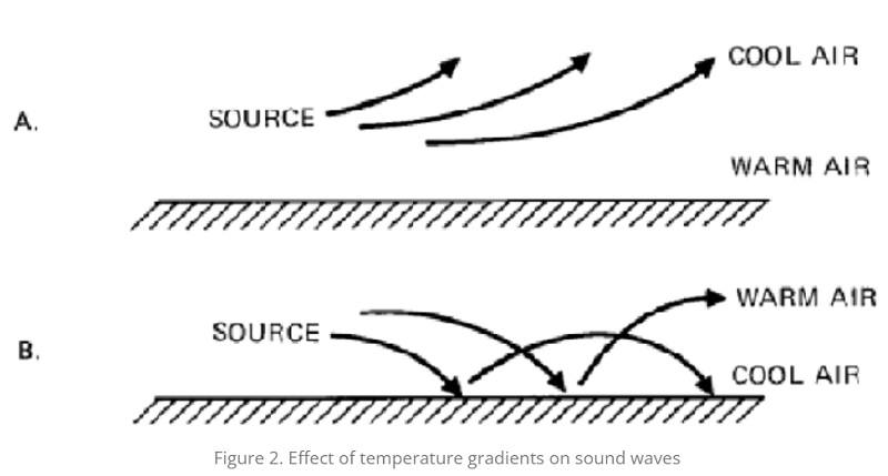

The speed of sound in air increases with increased temperature. This suggests that an air temperature gradient will refract sound. So I searched air temperature gradient refract sound, and found this diagram:
This suggests some interesting experiments with a temperature sensor or data logger on, say, a drone.

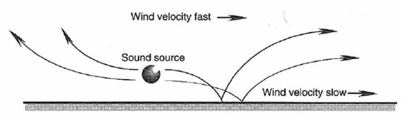

A wind velocity gradient will do the same thing:
If there are buildings or trees between you and the highway, and wind blowing towards you, then there will be a wind velocity gradient at treetop level. This gradient is well known to pilots when landing in a crosswind with a tree line upwind. And it suggests some experiments with a kite.
