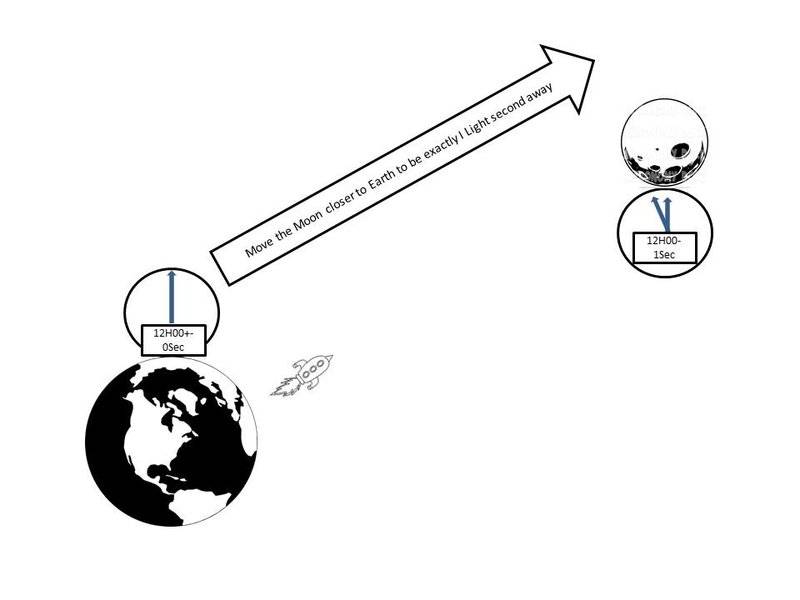

If we work on the following thought experiment:
We will move the moon closer to the Earth to one light second (and we will play that this is 300 000 Km/ one light second rounded up)
We will build 3 clocks, special clocks that is visible over 300 000 km, and travel at a slow speed with all 3 to exactly the middle of the distance from the Earth to the Moon where we will meet an awaiting ship and deliver one clock to be placed on the Moon. [This will ensure that if Time dilutes during travelling, all 3 clocks will now be exactly synchronized.]
We will now return to the Earth with the remaining 2 clocks and will place one on the Earth, and one on a very special spaceship that can travel at the speed of light, minus 1 meter per second. (for the benefit that we can not travel at the speed of light, or faster.) [But for this experiment we won't go to calculate the finer details, and will assume that the calculator we use don't have such detail, but will round the one meter up to one light second of speed we can travel]
Now the experiment.
Our spaceship will leave exactly at 12H00 as the seconds hand set us off to the moon.
When we left the Earth, the clock on the Moon (visible from earth) showed one second before 12H00, as the one on Earth was at 12H00 exactly.
Our spaceship travels to the Moon, and upon arrival we check the time on the Moon clock, which will now say what?
12 H 00+1 sec / 12H00 exactly?
What will the clock on the spaceship say?
12H00+1 sec / 12H00 / 12H00-1 sec.
What will the clock on Earth say?
Now the experiment.
What will the clock on Earth say?View attachment 219425
Let me give you some of the answer. Let's not worry about the clock on the spaceship for now. To confirm my understanding of the experiment:
We have a clock on Earth and a clock on the moon that are synchronised, in the Earth-Moon reference frame.
A rocket leaves Earth and travels at near the speed of light (as measured from the Earth and/or the moon) and reaches the moon in about ##1s## (as measured from the Earth and/or the moon).
The moon clock reads 12:00:01 when the ship arrives, as does the Earth clock - although it takes a second for the light to reach an observer on the moon, so they see the Earth clock always 1s behind. In this case, showing 12:00:00, when looked at from the moon.
You don't need any relativity here. That answer comes simply from the definition of speed in terms of distance/time. This is nothing to do with the theory of relativity.
That is the part of the answer I wanted to give you.
Now, what is happening in the reference frame of the ship is another matter. For that you definitely need the theory of relativity.

What you say here is all true, with one crucial exception. The ship cannot travel at the speed of light. Let's say it travels at 99% of the speed of light. Then, in the Earth-Moon frame, it takes 1.01 seconds to arrive at the moon, so when it arrives the moon clock reads 12:00:01.01, and looking back at the Earth clock, it reads 12:00:00.01 Other than that, I agree with what you said. Where is the problem?
He specifically said "NEAR the speed of light" and I don't think he had 99% in mind. More like 99.99999999999% so his figures are correct.
Regardless of how fast he is going, he cannot leave Earth with the clock reading 12:00:00, then arrive at the moon and look back and see the Earth clock reading 12:00:00. I wanted to make sure he understood this point.
Look at it this way. He leaves the Earth with the Earth clock reading 12:00:00 He's traveling at essentially the speed of light, so both he AND the light showing the reading on the clock at the time he leaves take the same amount of time to reach the Moon, so yes, it does read 12:00:00 when he gets there even though it has, by then, progressed to 12:00:01 in its own FOR.
My point is just that he isn't traveling at the speed of light, so when he looks back at the Earth clock after arriving at the moon, it cannot read 12:00:00. It must read 12:00:00 + "a little bit". We can argue about how small "a little bit" can be, but it cannot be zero. Do you disagree?
Yes, I disagree. Clocks only have certain accuracy. To any required experimental accuracy a journey of ##1c.s## can take ##1.0s##.
In fact, if we assume that the clocks only show the time to the second, then any rocket speed greater than ##c/2## would do! Albeit, such a clock may not be ideal for this experiment.
Ah. I somewhat missed your point, but I do agree w/ PeroK that for all practical purposes is DOES read 12:00:00
I'm afraid we're hijacking the thread oin an irrelevant side issue. We all agree that clocks have finite accuracy.
@P J Strydom , can we get back to what you are having difficulty understanding. Please state your problem.

3. The clock on The spaceship reads the same as what Earth's clock says.
4. My twin brother is on the space ship, and pulls away with this special spaceship at almost the speed of light. at 1 Jan 2018 (Earth Clock and Space ship clock say 1 Jan 2018 / ProxC say 1 Jan 2014)
5. As my brother travels to ProxC, he observes that the ProxC clock runs 2X faster than the Space ship Clock. (due to him traveling into the light of old light in transit to the Earth over 4 Years of travel.)
6. My brother turns back and sees that the Earth Clock is standing still at 1 Jan 2018. (because he is traveling with the light that left with him on departure.)
7. My brother arrives at ProxC on 1 Jan 2022, and finds that the ProxC clock is exactly the same as what the Space ship clock reads. (ProxC was minus 4 years when he left Earth, and as my brother traveled for 4Years, and read all the old light light from 2014 to 2022 from ProxC clock. He gained 4 Years since he traveled from Earth in 2018 and it is now 2022. (ProxC = 1 Jan 2022, Space ship = 1 Jan 2022, but Earth clock =1 Jan 2018)
Checkpoint time dilation observation!
Here we see that even though my Brother traveled from reference frame Earth, to ProxC , in reference frame Space ship, the reference Earth clock stood still for 4 years, the reference frame ProxC advanced by 8 years, and the spaceship reference frame remained constant 4 years of travel.
The quest continue
8 Without missing a beat, My brother returned to earth. (He left in 1 Jan 2022 on spaceship clock and as he departed, he saw ProxC was the same; but Earth was still on 1 Jan 2018)
9 as he traveled, he saw that the Earth clock was now turning 2X as fast, because he is now traveling into old light that left the Earth in 2018 to 2022 and new light from 2022 to 2026.
10. He also notice that ProxC clock is now standing still on 1 Jan 2022, because he is traveling with the light that left when he did.
11. At the halfway mark, My brother looks at his clock, and it say 1 Jan 2024, the Earth's clock is now on 1 Jan 2022, and the proxC clock is still on 1 Jan 2022.
12 My brother arrives on 1 Jan 2026, after traveling return flight of 8 years.
13. The spaceship clock says it is 1 Jan 2026, the Earth clock say it is 1 Jan 2026, and proxC say it is 1 Jan 2022.
Checkpoint Time dilation observation!
Again, my brother traveled from Earth to ProxC and back in 8 years since 2018 to 2026.
The clock on the Space ship shows 2026, and ProxC shows 2022.
Now, on the:
A. Reference frame earth, i saw the clock on ProxC move from 2014 to 2022. Earth clock from 2018 to 2026, and the spaceship clock showed 2018 when it left, and a blackout of light because it was traveling linear to proxC with the light that left and I could not see the spaceship clock for 8 years until 2026 when it arrived here on Earth with the light that came from ProxC when he turned around in 2022.
B. Reference frame Space ship. My brother saw the light of Earth remain at 2018 until he arrived at ProxC. and proxC clock was running 2X faster than his own clock because he was gaining 4 years of old light, and 4 years of light that departed from ProxC since he left. He saw ProxC clock advance 8 years.
C. From reference point proxC the Earth clock was at 2014 and advanced to 2022, itself showed 2018 and advanced to 2026. The spaceship clock light did not show up until it arrived at ProxC with the light that it left with in 2018, and as it left ProxC, the light of the spaceship clock from 2022 to 2026 will not be seen because the spaceship is traveling with the light linear to Earth, and no light reflects in line from proxC to the Space ship to reflect back to ProxC, because the spaceship is just too fast for the light to reach it. However, the light coming from the spaceship from Earth from 2018 to 2022 now arrives from 2022 to 2026 showing the spaceship in reverse. This will be observed up until 2026, and the spaceship will disappear for 4 years where there was no light that reflected back from the spaceship to ProxC.
This is what I see in reality, and I still do not know where the heck Time diluted?
Come on gentlemen, don't tell me to go and study the maths.
Where is my mistake?

Bill, you saw my thought experiment made by some MIT graduate on internet, and I think you might be able to see my predicament.
Look at the Twin Paradox as I placed it and please tell me what I am understanding wrong.
I see that Time remains a constant, but it is only the observation of light from 3 reference frames that seems to influence time.
In other words, all the explanations I saw from well established science descriptions is that they are telling me that because we observe, from the Earth (eg.), that a moving object flying away from us we see the light arriving slower at us because of the time light takes to get to Earth from the rocket.
Do you see where I am getting stuck?
Is the theory of Relativity simply a way to determine where a specific object is in space by measuring the arrival of its light in another time frame?
Because if this is what Relativity actually is, then Time dilation does not exist, and length contraction is simply a calculation on the observation of the same object's light leaving its front and rear and arriving at different times at my time frame. So, why all the fuss?
now you see my problem.
After all what I tried to learn, I still do not know what G&SR is, and no one can tell me?
So, what are all the great scientists doing with G&SR?

Part of your problem is this: "(lets ignore the fact that it travels at 99.9999999* the speed of light.)". As I said in Post #10, you cannot do this. You are basically throwing out the baby with the bath. Try again with the assumption that the spacecraft is going at 50% or 75% or 99% of the speed of light.
OK , so let's us travel at one half of C.
Redy...Steady...
Departing from Earth in time frame Earth we see
Earth Clock = 2018
Space ship Clock= 2018
ProxC Clock= 2014
At time frame Space ship we see
Earth Clock = 2018
ProxC Clock= 2014
At time frame ProxC Clock we see
Earth Clock = 2014
Space ship Clock= 2014
ProxC Clock= 2018
Go!
Arriving at ProxC in time frame Earth we see
Earth Clock =2026
Space ship Clock= 2022
ProxC Clock= 2022
Earth Clock = 2022
Space ship Clock= 2026
ProxC Clock= 2026
Earth Clock =2022
Space ship Clock=2026
ProxC Clock= 2026
And Hi!
Arriving at Earth back from 8 years return, in time frame Earth we see
Earth Clock =2034
Space ship Clock=2034
ProxC Clock= 2030
Earth Clock = 2034
Space ship Clock= 2034
ProxC Clock= 2030
Earth Clock =2030
Space ship Clock=2030
ProxC Clock= 2034
Again, here we traveled at half the speed of C, but we know what every clock says and I do not see the Twin gaining on Time?
Gentlemen, what is Relativity, and where do they get this idea that Time runs slower for a traveler?
is there no one that can tell me?
I will go and learn the mathematics, but hell guys, please just explain where Tine started to run slower or faster, because I see that the explanations by Physicists is only a description on how light is observed, and not that time dilates?
