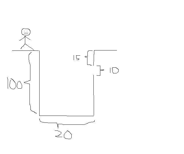

Alice, Bob and Daniel are standing on the edge of a canyon which is 100m deep and 20m wide. On the opposite side of the canyon there is a 10m high cave, 15m below the top of the cliff. They each throw a rock horizontally with the following initial speed to see who can get it into the cave.
Alice rock speed 5m/s
Bob rock speed 10m/s
Daniel rock speed 20m/s
for this qn, i do not understand why initial velocity is 0...hmmm ? becoz only with the initial speed as 0 can i work out the correct ans...if i were to use the values given, i will get a wrong ans...

RE: AM's post. You need to work out a range of initial velocities. As the intial velocity is horizontal, there is no angle. Consider the horizontal (x) and vertical (y) components separately.
Horizontally
You know that horizontally the rock must travel 20m (the width of the canyon). Ignoring air resistance etc., this velocity is constant, therefore the intial velocity is given by;
[tex]V_{x} = \frac{20}{t}[/tex]
Vertically
You that vertically the shortest distance the rock must fall is 5m (I'm assuming the 15m is measured to the base of the cave as I cannot see your diagram). Ignore air resistance, the only acceleration acting in the y plane is gravity, therefore using kinematic equations the minimum time taken for the rock to fall 5m is given by;
[tex]t = \sqrt{\frac{2s}{a}}[/tex]
Now, if you input this time into the equation for horizontal velocity, this will give you the maximum intial velocity.
Next you will need to work out the maximum time taken for the rock to fall vertically (15m), then input this time into the Vx equation to obtain the minimum intial velocity.
Do you follow?
~H
diagram ...
Thank you for the diagram Ukitake, however, it will probably take a while for the mentors to approve this attachment. Do you understand what I was saying in my previous post?
~H

Okay, in light of your diagram the vertical range requires alteration, however the horizontal component still holds (the rock still must travel a horizontal distance of 20m).
Vertically
Vertically, the minimum distance the rock must fall to enter the cave is 15m and the maximum distance is 25m. So we can now apply equations of uniform acceleration to find the flight time. The equation required is s = ut + 1/2at2. As the rocks are thrown horizontally the intial vertical velocity is zero, thus the "ut" term drops out leaving s = 1/2at2. Rearranging to find t gives;
Next you need to substitute in the maximum and minimum values for displacement (s) to obtain the maximum and minimum values for flight time. After obtaining the times you need to substitute them into the equation for horizontal motion to obtain the minimum and maximum intial horizontal velocities. Any velocity which lies between these two values will result in the rock being thrown into the cave.
Do you follow?
~H

in order to work out the velocity i need acceleration and since acceleration of horizontal plane is 0. that keeps screwing my answers
The acceleration in the horizontal plane is zero.
However, the acceleration in the vertical plane is _____ m.s-2?
Consider the horizontal and vertical components completely sperately.
~H

No. But you can work out the time taken for the particle do fall the required distance. Have you read my posts?
~H
~H
yes
"Next you need to substitute in the maximum and minimum values for displacement (s) to obtain the maximum and minimum values for flight time. After obtaining the times you need to substitute them into the equation for horizontal motion to obtain the minimum and maximum intial horizontal velocities. Any velocity which lies between these two values will result in the rock being thrown into the cave."
i can work out the max and minimum times for flight which is 2.25 and 1.74 respectively. i am a little confuse about the 2nd part of the paragraph esp on the "minimum and maximum inital horizontal velocities"...

Okay. Now if we consider the horizontal plane only; there are no forces acting (we are neglecting air resistance etc) so there is no acceleration thus the rock will be traveling at a constant horizontal velocity. Know as you know the equation for constant velocity is;
[tex]v = \frac{\Delta s}{\Delta t}[/tex]
Now, we need to find the velocities that will allow the stone to travel the 20m into the cave in the time taken for the stone to fall the required distance - the times you found above. Do you follow?
~H

yes! with this i can find the correct ans...thanks
but the time taken is for the stone to fall in the vertical axis, i can use it to find velocity? in the horizontal axis? becoz in my textbook, they separate this type of qn into x and y component...
certain vectors are only exclusive to either x or y components...is time an exclusive component?
Yes, time is constant in both components. Think of it this way, a runner sets of at a constant velocity of 5m.s-1 east. A car starts from the same point at the same time from rest but accelerates at a rate of 10m.s-2 south. After 5 seconds what is the velocity of each? What is the displacement?
This exactly the same principle.

ok...becoz all along i tot, there is a diff time for each component and each are exclusive so i can't use the time for vertical on the horizontal component...but now i see...thanks everyone for all the help :smile:
I think we've just had a break through :biggrin: . No problem, it was a pleasure.
