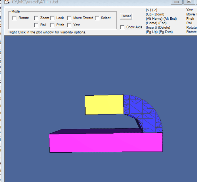

How do we solve the geometric coincidence problem? I need a semi-cylinder that fits into the cuboid but if I use the cuboid and the cylinder directly it's geometrically problematic
I'm not quite following the question. MCNP does Constructive Solid Geometry. Shapes are supposed to intersect and then you tell it which volumes are what part of the problem.

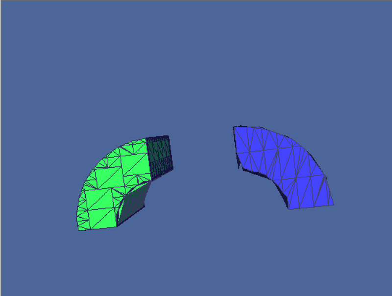

I set up four cubes but only two are displayed. In my setting, there should be cuboids in the middle and under the ring. Why?
In a cell definition a positive surface typically means above or outside. A negative surface means below or inside. If you take a look at cell 3, you have -3 4, meaning below x=4 and at the same time above x=6. The space between x=4 and 6 is "3 -4". Now have a look at cell 4 and see if you can find something similar.
Thank you very much Alex A, I got the X-axis wrong. The sign of 1, 2,3, and 4 surfaces in the surface card is wrong

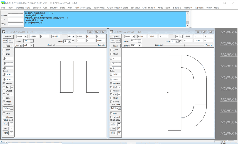

However, after I corrected the error of x axis, the modeling problem still occurred in cell card 1. Why is cell card 2 and cell card 1 written in the same way? cell1 caused the problem, but cell2 did not

MCNP seems happy. When I try the interactive plotter I see the full D. VisEd does not seem happy from your picture. Maybe VisEd does not like the comment. I do not see an error.
