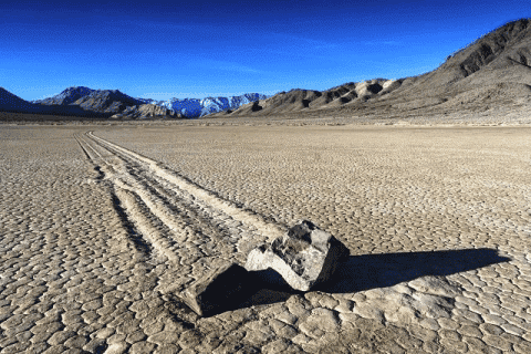

It works a lot better if you use rocks in the desert...
https://www.nationalparks.org/connect/blog/sailing-stones-death-valley

The linked article seems to suggests the motion is due to very particular weather effects, not due to Earth’s rotation.
I debated whether to add a winkie emoji to my post...
You university professors are so serious and literal... :wink:
