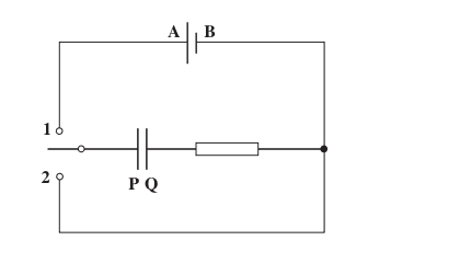

So, is this true for when a capacitor charges through a fixed resistor (as shown in the image below, when the switch is closed to 1)- the potential difference across the resistor exponentially decreases to zero and the potential difference across the capacitor exponentially increases from zero to equal the voltage across the battery (power supply), when the capacitor is fully charged?

Yes.

Ok, so now if the switch is moved to position 2 and the capacitor is now discharging. The potential difference of the capacitor will now decrease exponentially, and so does the potential difference across the fixed resistor- why does the p.d across the fixed resistor also decrease?

Capacitor acts as a source while discharging and voltage across capacitor is equal to the voltage across resistor. Since capacitor voltage is decreasing, voltage across the fixed resistor is also decreasing.
In other words, resistor does not store any charge. Hence, voltage across the resistor decreases while discharging of the capacitor.

Ohhh I see that makes sense, just one more question why in: VC= -VR is the p.d across the resistor quoted as a negative value?

It follows from KVL i.e. Vc+Vr=0. Going along the direction of current, you'd see a drop in potential across the resistor and a gain of potential across the capacitor.

Ok yeah makes sense, so when the capacitor is discharging the p.d across the capacitor increases so the p.d across the resistor decreases in order to = zero. And then when the capacitor discharges VC= -VR as both the p.d across the capacitor and p.d across the resistor decrease to zero.

Ok yeah makes sense, so when the capacitor is discharging **charging** the p.d across the capacitor increases so the p.d across the resistor decreases in order to = zero
Right.
