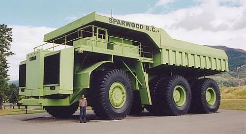

Tires 4 meters in diameter? Those are some big tires. Must be driving some kind of Earth mover. :biggrin:
doh! for some reason i took 4m to be the radius. Stupid words...
