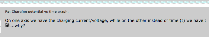

On one axis we have the charging current/voltage, while on the other instead of time (t) we have t ...why?
And yeah...latex is still giving problems?...I think I got a cache problem.
This picture shows what I'm seeing:
Actually I'm on linux, and so this website seems MS friendly.
So that 'tau' seems like a matrix in windows.
So if you encounter any sort of weird symbols, take it as 'tau' or time constant.
So are you trying to write [itex]t / \tau[/itex]?
ITs t*tau not t/tau.
Latex just started working for me!
[tex]t \tau[/tex]...this is what I mean.
:confused:
I've seen many capacitor charging/discharging graphs that use [itex]t / \tau[/itex] on one of the axes, but never one that uses [itex]t \tau[/itex]. Are you sure the [itex]\tau[/itex] isn't a subscript, i.e. [itex]t_{\tau}[/itex]?
Are you referring to graphs like this one?
The horizontal scale markings indicate [itex]t = \tau[/itex], [itex]t = 2 \tau[/itex], [itex]t = 3 \tau[/itex], etc. This means the same thing as [itex]t / \tau = 1[/itex], [itex]t / \tau = 2[/itex], [itex]t / \tau = 3[/itex], etc.
The 1, 2, 3, etc. are not t's. t and [itex]\tau[/itex] both have units of time, so the numbers are dimensionless.
Yeah...the same thing.
So why did this [tex]\tau[/tex] stuff pop by?...why not simply use time?
Normalization, the time constant will vary between different values of R and C but as long as you plot the time axis in terms of the time constant then the plots will all be the same (barring differences in the magnitude of the initial voltage).
Oh...you mean to maintain the nature of the graph...right?
Yeah. Plotting in units of time constants allows the graph to be scale invariant with respect to the R and C of the circuit. It's the same reason why when we plot graphs of waves and such we use wavelengths as our units of space. It automatically scales the plots in such a way that the information of interest is readily seen.
Humm...ok, thanks!
