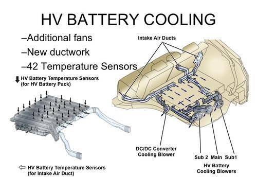

For example, with seven thousand 18650 cells the surface area is roughly 27 square meters. If there were an imaginary set of 20 much larger cube-shaped cells that enclosed the same volume, the surface area would be only 3.5 square meters, more than seven times smaller. Surface area is essential to cooling batteries since the surface is where heat is removed; more is better. Also, because of their small size, each cell is able to quickly redistribute heat within and shed heat to the ambient environment making it essentially isothermal. This cooling architecture avoids “hot spots” which can lead to failures in large battery modules.
Ah good point.
I'm hoping that if cooling spaces or channels are needed, they would be incorporated into the mold of the case. I emphasize "mold" meaning that it is a one-shot process and it does not require manual labour to drill holes or inert parts etc.

Chevy volt battery has active cooling and will borrow "cold" from car airconditioner in hot weather.
Here is Toyota's, from the slideshow in that aticle:

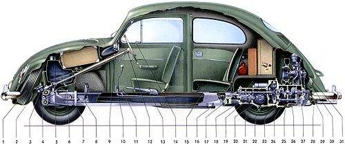

EDIT: I spoke too hastily. Those have their fuel tank located in front of the driver, don't they, not well placed for head-on impacts?
It appears to sit right over the front axle assembly. That assembly is robust tubes with torsion bars inside.
photo courtesy these guys: http://www.vwbug.com/cutaway/cutaway1000.html
Not too bad in my opinion - to crush it from the front you'd have to move a LOT of structural sheet metal. Were it between front bumper and front axle it'd be a Pinto setup- right in the crush zone.
What a wonderfully simple design - doesn't even need a fuel pump ! Anything that's not there can't quit working and strand you .
