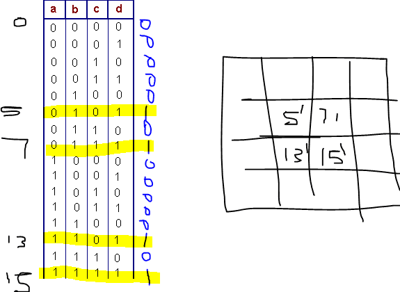

How do I start my truth table? like this?
A B C D | Output | AB | CD
How will I form the expressions from the truth table?
I know how to solve with a K-map, but I'm having a hard time visualizing and building it.

Okay I uploaded a picture. I put the 1's in the K-map after and now i need to form the expression. I build the circuit from the expression then?
  • Handwritten truth table with columns a, b, c, d and rows 0 to 15, with rows 5, 7, 13 and 15 highlighted in yellow, beside a handwritten 4-variable Karnaugh map with the cells 5, 7, 13 and 15 marked.
That table doesn't make any sense to me.
The Truth Table for this 2-bit multiplier should have 4 columns of input bits and 4 columns of output bits. The output bits for each row are the binary result of multiplying the two 2-bit input binary numbers.
Try again? :smile:

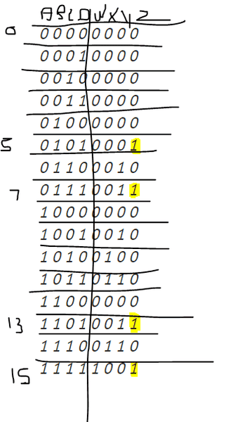

I uploaded another.. I don't understand how to get the highs in the x,y,z outputs though, what am I looking at to form the logic?
  • Handwritten truth table with inputs A, B, C, D and outputs W, X, Y, Z, listing 16 rows of binary values from 0000 to 1111, with some output 1s highlighted in yellow.
Much better! :smile:
So now you design 4 logic circuits, one each for the W, X, Y and Z outputs. The 4 inputs (A, B, C, D) go into each of the combinatorial circuits.
Use 4 K-maps to design the 4 logic circuits. Can you show us your try at the 4 K-maps?

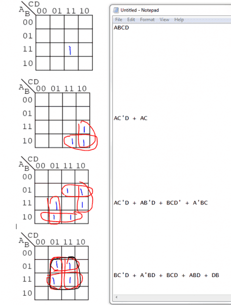

Here's a look at my K-Map and expressions. Now I take the expressions and build the circuit in a testing program?
  • Four Karnaugh maps with AB rows and CD columns, each showing circled groups of 1s, beside a Notepad window listing the Boolean expressions AC'D + AC, AC'D + AB'D + BCD' + A'BC, and BC'D + A'BD + BCD + ABD + DB.
Great! I checked the K-maps and they look right for W, X, Y and Z (from top to bottom -- they should be labeled).
And yes, now just write down the circuits that correspond to those minterms. Good work. :smile:
Thanks for your help, appreciated greatly! I never turned a big expression like B'CD + A'BD + BCD + ABD + DB into a circuit before. Do I take the expressions for w,x,y,z and put them altogether?
No, you will make 4 separate circuits; one each for the W, X, Y, and Z output bits for the multiplier. You make each circuit with inverters, AND gates and OR gates (that's one way to implement minterms anyway).
Can you help me set one up, preferably a harder one?
AC'D+ AB'D + BCD' + A'BC
Ramir said:
Will I have three Or's in that expression?
Yes. Sorry for the delay in responding.
You implement that with inverters, AND gates, and OR gates. For the terms like C', use an inverter to make C' from the C input. For terms like AC'D, use a 3-input AND gate. And then use OR gates to implement the "+" operations.
