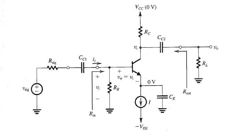

Can someone please explain to me with what reasoning RL and RC are taken to be in parallel when calculating Vo for any decrease/increase in IC (DC) due to isig (ac)
Thank you

In AC analysis there should be a very low impedance between ground and Vcc. Likewise Cc2 is assumed to be a short, thus RL and Rc are in parallel.
