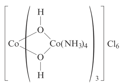

What are the oxidation states of the cobalt ions?

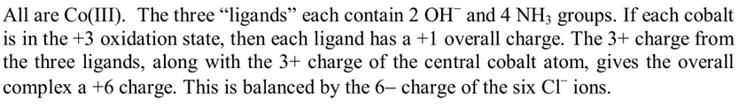

oxidation state of central cobalt is +6 due to 6 oxygen surrounding it,The other cobalt is +2 due to 2 oxygen surrounding it with NH3 ligand which is no count for oxidation state.

Let us evaluate your answer. You say that the central Co is +6 and each of the three “ligand” Co complexes contains a Co+2. This gives a total charge of 6+2+2+2=+12. This total charge is balanced by only 6 Cl-1?

@chemisttree I feel like you may have missed 6 OH-?
You’re right, I did miss the the 6 OH-1. 😐

According to textbook, what you said is true but I still have to tackle the exam...please educate me why its oxidation number is 3 for all cobalts

You would have to know that Co+6 is not a known oxidation state of cobalt. That unknown ion (maybe you will find it in the sun’s coronasphere) would be isoelectronic with scandium. [Ar]4s23d1 would be pretty unusual for Co, right? And try to add six pairs of electrons to that and see if it looks right to you?
