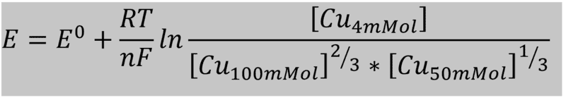

Thanks,
So the reacting ion present on both sides is Cu++.
Trivial to derive - just ratio of concentrations.
For a Chemist for sure!
for example we have 2/3 volume of CuCl2 100 mMol and 1/3 CuSO4 50 mMol at left
and
100% CuCl2 4 mMol at right?
Thanks for the reply.
Does that means if we do not have access/know the volumes of each concentration, the computation is not possible?
Yes, that's what it means.
Thanks,
A last (?) question: What happens when the cell volumes are different, V1 for the left and V2 for the right one ?
Volumes don't matter when it comes to the potential, Nernst equation contains only concentrations.
Amounts of substances play a role when you want to find the capacity of the battery, but that's another story.
