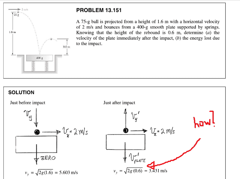

Hello, I am having trouble understanding the logic behind the solution to the posted problem. How did they deduce the equation for "Just after impact" ? I don't see how
$$v_y = \sqrt{2g(0.6)}$$
What assumptions did they make or how did they get this simplified equation?
I understand how they got the formula for "Just before impact"
In the y direction:
$$mg(1.6)+0.5m(0)^2 = mg(0)+0.5mv_f^2$$
$$v = \sqrt{2g(1.6)}$$
But I don't see how they applied this formula for "just after impact"
Any guidance is really appreciated.
Thank you for your time.
They are applying the formula for motion under constant acceleration because there is a resultant force acting on the plate. It is actually v2=u2+2as
So what happened to u2 ? Why is it assumed to be 0 here?

Apply the same logic for the energy of the system after collision.
u is not assumed to be 0. Look back at the previous diagram and u will know why =)

Use the same equation for conservation of energy mgh+0.5mvy2=constant, but with initial height 0 and velocity unknown and final velocity zero at height 0.6 m.
