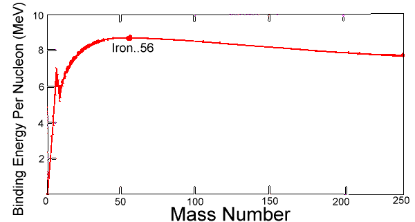

The graph below shows how the binding energy per nucleon of a nucleus varies with mass number A
(graph is given below)
Let region P is around mass number equals to 5, region Q is around mass number equals to 50 and region R is around mass number equals to 200
Which one of the following statements is not true?
a. The binding energy per nucleon increases most significantly at lower nucleon numbers
b. Nuclei in region Q are more stable than nuclei in region R
c. Nuclear fusion reaction bring nuclei closer to region Q
d. Energy is released in nuclear fission reactions from nuclei in region R
Not sure
Option A is correct because the graph increases sharply at lower nucleon number
Option B is correct because higher binding energy per nucleon means more stable
Option C is correct because either fusion or fission will bring the product to Q
So my guess the answer is D but I do not understand why
Thanks
Graph of binding energy per nucleon in MeV against mass number from 0 to 250, rising steeply at low mass number, peaking near 8.8 MeV at a label reading Iron-56, then falling slowly to about 7.6 MeV at mass 250.
Regardless of the mass numbers of the original atomic species?
Yes I think so
haruspex said:
Then how are elements past Iron created?
Ah I see. In star the formation of heavier element than iron is through fusion. So the answer should be C.
Thank you very much
Sorry haruspex, my friend said the answer to this question is D (based on the answer key)
I didn't study D. Yes, that is wrong, but I had not interpreted the question as implying only one was wrong. I believe the correct answer is C and D.
I am sorry for late reply
Why is option D wrong? I think nuclei in region R will be more likely to undergo fission and fission reaction also releases energy
Thanks
Thanks
Sorry, I have no idea why I wrote that. Must have misread something.
So in your opinion C is the answer? Thanks
