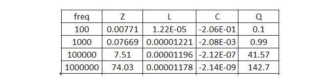

I am measuring with LCR meter and also to my surprise i got C values as negative, i measured for four times even by changing the terminals also but the result is same
I have attached the measurement values with this mail.
it will be just an error in the way you are measuring the component values

Regarding the negative values for capacitance... Did you just apply an LCR meter set on the C range to the windings of the transformer? If so I suggest you read up on how an LCR meter works. Then think about what might happen if you measure an inductor with it set to the capacitance range.
