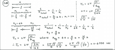

A helical spring of stiffness k is cut into two halves and a mass m is connected to the two halves. The natural time period of this system is found to be 0.5 sec. If an identical spring is cut so that one part is one-fourth and the other part is three-fourths of the original length, and the mass m is connected to the two parts, what would be the natural period of the system?
Attached is the solution. Why is k2 = 4k? I understand the solution up until that point.

Why did the textbookuse series of spring and not parallell springs Keq=k1+K2?
Not sure which step you are referring to.
The working has two stages. First, we need to find the effective k of each section of the cut spring. E.g. for the 1/4:3/4 split:
We can think of the uncut spring as these two sections in series:
##\frac 1k=\frac 1{k_{\frac 14}}+\frac 1{k_{\frac 34}}##.
Using the argument in post #4, we know that ##k_{\frac 14}=4k##. Substituting that leads to ##k_{\frac 34}=\frac 43k##.
In the second stage, we consider inserting the mass between the two sections. At the mass, for a given displacement, the two forces add. This is the same as for springs in parallel, so we use ##k_{net}=k_{\frac 14}+k_{\frac 34}##.

I have thought this until I recognized this:
The work is done on two steps for each case (taking the first case as an example):
- finding the new spring constant (k1) for each sector w.r.t the previous stiffness (k)... which make him use series leadind to (k1 = 2 k)
- finding the equivalent stiffness for the whole system (4k)... and then completing other steps
