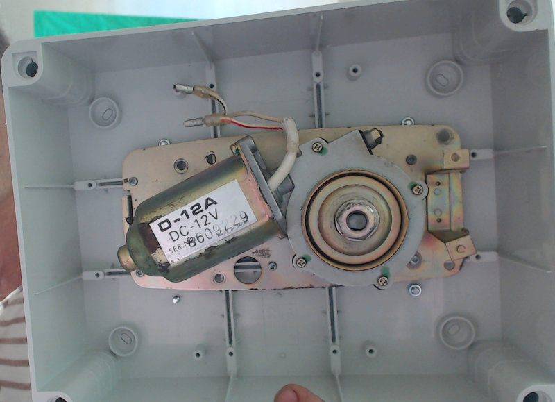

I have a combined motor and screw drive (to 90 deg).
It's original purpose was to convert car windows to electric drive... my guess is that it is at least 25 years old, and made in Japan.
For scale... the width of the motor casing is 50mm (as you look at it)
I'm making a motorised turntable.
The jig is coming along nicely, but I need to start thinking of a PSU and could do with some assistance.

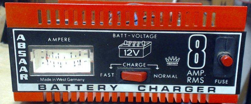

I don't have a PSU but I've tested the motor momentarily on an 8A battery charger.
It rotates at a reasonable speed ie. around 120 rpm.
(I attached an indicator wire to the output shaft and counted 60 turns to 30 seconds)
This is in the ball park area (by amazing good fortune)
It probably has more potential power than I need... primarily I'm looking to rotate up to a motorcycle barrel.
Clearly it would be nice to control the speed... perhaps a bit faster, or a bit slower (more likely).
Maybe I need to have adjustable voltage... perhaps that would be useful for bringing the turntable up to speed.

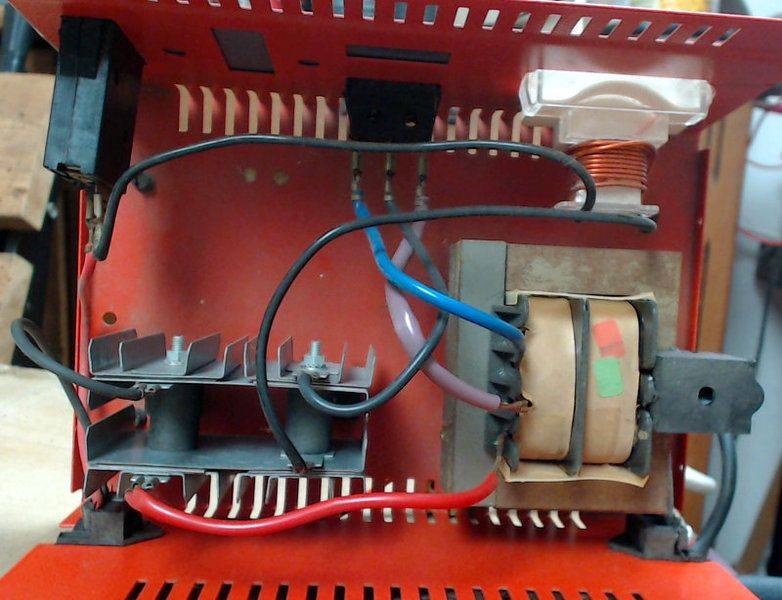

My advice is find a secondhand car battery charger at a yard sale or junkpile .
I just returned from my scrap metal recycle yard where there's a pile of about twenty of them .
Most often it's just a broken cord or meter or thermal overload that's gone wrong. The transformer and rectifier are usually salvageable.
marcophys said:
Question
Does this mean that the motor requires 144W regardless of the voltage?
I suspect the D12A is a model number not its current rating. 144 watts is almost 1/5 horsepower which should lift 110 pounds 1 foot per second.
It might draw that much if stalled though. You'll have to test it to see.
DC motors draw current in direct proportion to their load. Unloaded it'll probably draw only an amp or two is my guess.
Be aware that some window motors have a rubber safety clutch inside that round gear . Its purpose is to limit how much torque the motor can apply to the window lift mechanism so as to not cut off a limb when kids are playing with the electric windows. It shears and you have to replace it.
Yours may not, some simply use a lower torque motor.
No. It means the amount of current can be as high as the rated 12 amps (provided it is 12 amps; see Jim's post #4). At 12 volts, and 12 amps, electrical input to the motor is 144 watts (12V x 12A =144 watts).
How much current flows through the motor depends on mechanical load at the output shaft. As mechanical load increases, so does the amount of torque (current) required to turn it.
For example, perhaps once you've loaded it, the motor demands 6 amps at 12 volts (72 watts). 72 watts of power requires 6 amps at full speed (12V). If the speed-to-power relationship is linear (possibly the case here, but not so with fans and pumps, and a variety of other loads) you can estimate how slow you can go. 6 volts (half speed) is required to create 72 watts at the 12 amp rating limit.

I have a Makita fast charger DC1401
It delivers 14.4V 4.5A = 64 watts

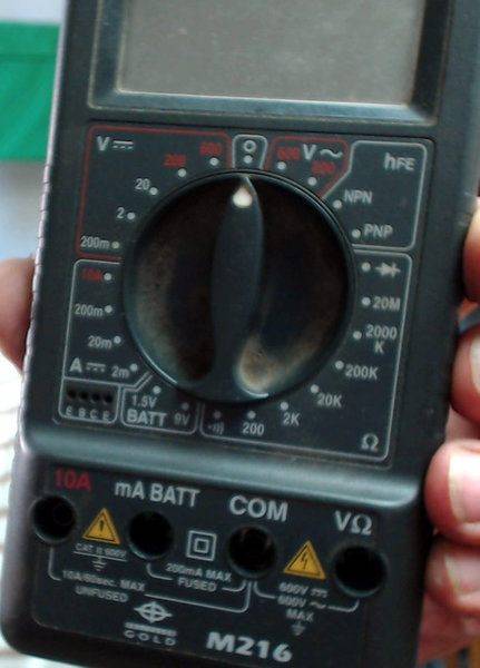

I'd check what no-load current draw is, and what it increases to when loaded.
Do you have a way to measure DC current?
If not, get a 0.1Ω, 5 watt power resistor, place it in series with the motor, and measure voltage drop across it.
I=V/R, so a reading of 100 mV across a 0.1 ohm resistor = 1 amp, 10 mV=0.1 amp, and so on.
It isn't a bad idea to measure motor current this way even when a multimeter with a DC range is available; no worries about clearing the meter protection fuse due to start-up surges, etc.

Most basic DMMS can measure up to 10A ( fused) - or use the 0.1 ohm shunt as pointed above.-- I would be concerned that this motor can draw more then 12A, soooo, you may want to try with a 6V battery and get and idea of how much this will draw.
Controlling the DC supply. and therefore speed with a basic PWM is straight forward , once you know the parameters and limits of the motor.

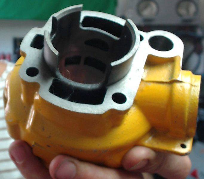

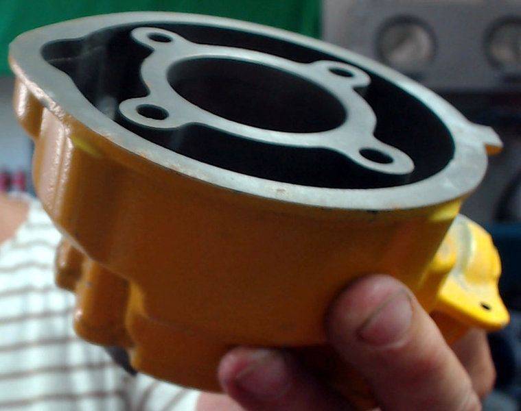

This is a typical 2T m/bike barrel:
The top photo shows the cylinder, surrounded by a cavity.
Within the cavity, circulates coolant - driven through a radiator (by a pump).
The bottom photo (top right) shows the large circular coolant duct.
It is through this duct, that the coolant is pumped.
Note: always carefully inspect this duct, to ensure it has been fully drilled, and that there are no obstructions - at pain of engine seizure.
Staying with the bottom photo... there are two arced ducts top and bottom (transfer ports).
The bottom duct (looking carefully) shows that it is split into two (at an angle).
Move your eyes up to the two arced oblong ducts (ports) in the cylinder wall.
These ports feed fuel into the cylinder (across the piston crown), and are fed via the transfer ports.
The third transfer port (top left) feeds fuel through a port not shown.
That port is angled upwards.
The fuel gas is injected upwards, displacing the remaining combustion fumes, forcing them out through the exhaust.
(note how the exhaust is opposite this transfer port)
The elliptical delve above the ports is an 'oil retention reservoir'.
Oil can become trapped in the rough surface, and drip into the cylinder, as the piston passes.
The piston glides through this cylinder, riding on 'piston ring' contact.
We need to carry oil molecules (oil bearings) between the piston and the cylinder.
We also need to eliminate snagging of the piston ring edge between the ports and delves.
We also wish to increase the hardness of both piston and cylinder, to enable them to act like true 'load bearing surfaces' and to minimise the transfer of aluminium (deposits) from the piston to the cylinder.
Note: Evidently there are numerous complex objectives to hand - the piston traverses the cylinder typically over 300 times per second - with an explosion over 150 times per second.
However, from this brief introduction, we can understand why we might wish to employ material modification techniques... and hence this project.​

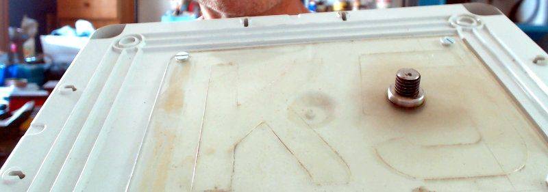

Here's where the project is:
  • Window motor
  • Cut down 10mm bolt - ground to the motor 'spline drive'

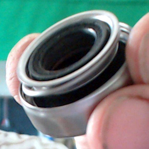

  • Modified water pump 'threaded ground spigot' (over the bolt thread)
  • Water pump seal (to ground spigot)
  • The above fitted in an IP rated electrical box.
  • Outer guide bearing and cover plate (combined) - perspex/acrylic vehicle registration plate.
    Note: Drills cut small in this plastic - allowing final cutting with metal polish between the spigot and plastic

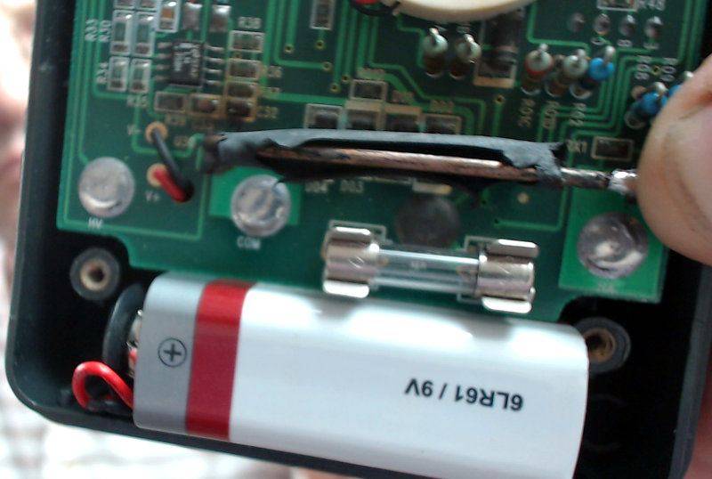

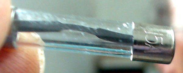

Here's a cautionary tale:
I had left my multimeter ON (for whatever reason).
When I came to it, I found the battery dead, the fuse broken, and the copper bar split.
I replaced the fuse, and soldered the bar - for no other reason than, that was all I could do.
My finger is touching where it was soldered:
I do not know the implications of this failure... perhaps somebody can enlighten me.
Here is the front face of the meter:

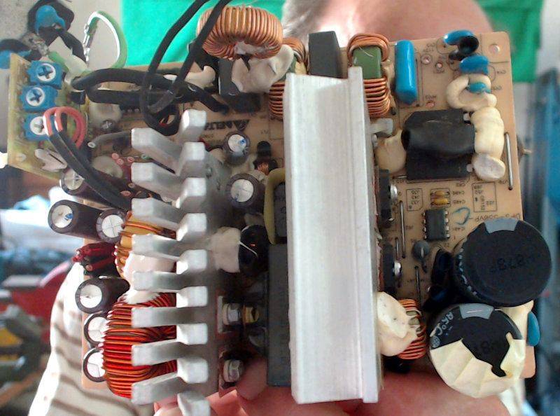

An old standard PC PSU might be useful:
It seems to contain plenty of resistors.
If anybody has any ideas on what bits might help us... that would be great.
Tomorrow I will start checking resistor levels.

So you want to mount the "barrel" on the turntable to do some process on it? The you mention "material surface modification through impact" - this part has nothing to do with the turntable, but you are looking to process the inside of the cylinder, this is with impact? -- kinda like honing - but with a "hammering" ? -- Sorry - it is just something I have not come across before - and am intrigued.
Shot peening perhaps?
Yes... but imagine whacking a static piece of metal with the ball end of a hammer: the delve would equate to the shape of the ball.
But if the metal is sliding past - perhaps the delve is elliptical - perhaps densification is reduced due to the spreading of the impact force across a larger surface area.
If the cylinder diameter is 47mm - the length of the steel = 147mm

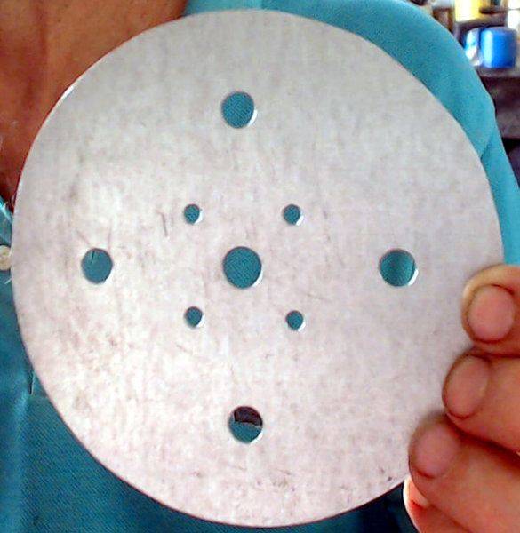

I wanted to get the turntable disc completed, because I knew it would be fiddly, and noisy to cut with a jig saw.
Anyway, it's done, and here it is:
This provides support options for large and small diameter workpieces.

If you have an old fashioned "Variac" adjustable transformer, that and a car battery charger works very well. Would get your experiment going quickly.
Old Ford windshield wiper motors had three brushes hence superior speed regulation. And lots of torque. If you can't close your speed control loop , consider that option for open loop.
No I don't.
I am currently testing with an 8A/4A battery charger.
Voltage
4A delivers 12V free of load
8A delivers 13.55V free of load
4A delivers 10.3V motor load - no weight
8A delivers 12V motor load - no weight
4A delivers 9V motor load - 1Kg
8A delivers 10.9V motor load - 1kg
4A delivers 8.7V motor load - 2Kg
8A delivers 10.3V motor load - 2kg

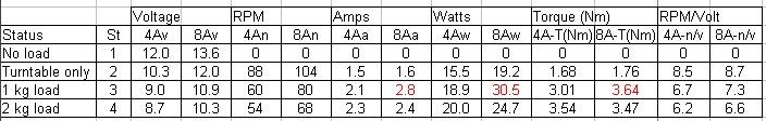

Load - RPM - Amps
4A delivers 10.3V motor load - no weight - 88 rpm - 1.5 A
8A delivers 12V motor load - no weight - 104 rpm - 1.6 A
4A delivers 9V motor load - 1 kg - 60 rpm - 2.1 A
8A delivers 10.9V motor load - 1 kg - 80 rpm - 2.8 A
4A delivers 8.7V motor load - 2 kg - 54 rpm - 2.3 A
8A delivers 10.3V motor load - 2 kg - 68 rpm - 2.4 A
Notes:
Again, there was variability.
Perhaps this is due to the past wear of the worm drive.
Bear in mind that we are not dealing with magnetic or airless bearings.
However, the results should provide a guide.
Perhaps a spreadsheet plot might throw up any human misjudgement.
What can we derive from the test results?
I'm thinking that the voltage should be regulated to a fixed voltage - say a figure less than 10 volts.
In this respect, the voltage would become fixed.
I need to test with the Makita charger specced at 14.4V @ 4.5A
But with a fixed voltage. this would stabilise the rpm, and only amperage would change.
... or is this unnecessary with PWM - in effect, itself stabilising the voltage?

The PWM controller in your previous post is an open loop control, and outputs 0 to 100% of input voltage (for instance, the battery charger) in increments as small as 1%. Increasing motor load will still reduce supply voltage, and since speed is directly proportional to armature voltage, speed will still fall off as load increases.
To obtain regulated speed control it is desirable to close the loop by measuring something representing speed, and using it for feedback. DC tach generators have a long tradition, but are ceding ground to rotary pulse generators and digital encoders. When measured speed drops below setpoint speed, the controller increases armature voltage to compensate, if speed is above setpoint it reduces armature voltage, and if measured speed equals setpoint it allows voltage output to remain unchanged.
Each feature adds complexity, but a 'true' motor controller also has a way to set minimum and maximum speed, to control acceleration and deceleration (accel/decel, which performs essentially what 'soft start/stop' does in your example), and some form of current limiting to prevent mechanical overload from blowing up the drive and/or overheating the motor.
The current measurement obtained on the 8A charger range with 1 kg load appears to be a mis-read (shown in red).

I have just tested the barrel (1.7Kg) @ 4A
Bizarrely it rotates at 52 rpm.
The expected rpm was 56.
This may be because it is not balanced (due to the exhaust).
The test weights were 'weight lifting' weights @ 1Kg each... so perfectly round.
Using the scientific methodology of just looking at it spinning... I think we are entering the working range.
Probably in the region of 30 rpm will be better.
Thank you very much for checking my figures.
My guess is that I have inadvertently swapped the figures between the 2kg and 1Kg loads.
If this is so, the table should read:
Load - RPM - Amps
8A delivers 10.9V motor load - 1 kg - 80 rpm - 2.4 A *
8A delivers 10.3V motor load - 2 kg - 68 rpm - 2.8 A *
* bold results swapped.

Motor Gearbox Examination
Lots of interesting discoveries made here.
I made a video, as it's easier to discuss each issue:
So the motor units were swapped.
This time, the shaft seal was included in the assembly.
Note the spring
The seal is from a water pump, has two seal faces, and apparently compresses the shaft seal, as the spring is compressed.
This, we discover, adds load to the motor.
The result is that the motor rpm has substantially slowed.
Clockwise = 34 rpm
anticlockwise = 68 rpm​
Is this just coincidence?
Very nice though, because by good fortune... so far, I have a two speed motor, and both speeds are where I want them to be.
Ahhhh!
Let's allow ourselves a brief glimpse of superstition, and suggest that this is karma :smile:

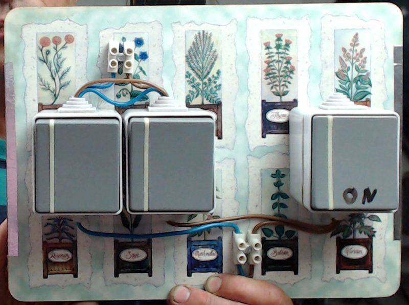

The 1.5 sq mm cable runs for approximately 10m.
This conveniently allowed my battery charger to remain in it's original position.
I didn't have a 'latching' reversible polarity switch - the window winder switch is 'hold to make contact', therefore:
The control panel was created using 3 x '3 pole' (light) switches, mounted on two 'cork backed dinner placement mats' (to provide screw depth).
2 switches were mounted side by side, with the inner and outer poles connected.
The third switch breaks the live feed.
The 2 switches controlling polarity reversal, require bridging (a bar, top and bottom, across the the switch interface).
The advantage of the large switch interface, is that they can be 'foot operable'.
It doesn't get better than that, as both hands are ensconced within 'operator gloves'.
The left foot controls the turntable... the right foot controls the ejection of the 'material surface modification media'

Joining The switches
The switch actuator is rigid enough, but thin.
Rather than hot gluing two bars... I will add material on the underside of each actuator.

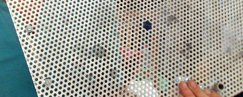

In this way, I can screw the bars in place.
This will enable easy dismantling, at some future moment.

In the video the gearmotor is noisier In one direction than the other. If you have it apart again, disengage the worm from the gear, and see if noise comes from the motor itself, or if it is (my guess) due to gearing.

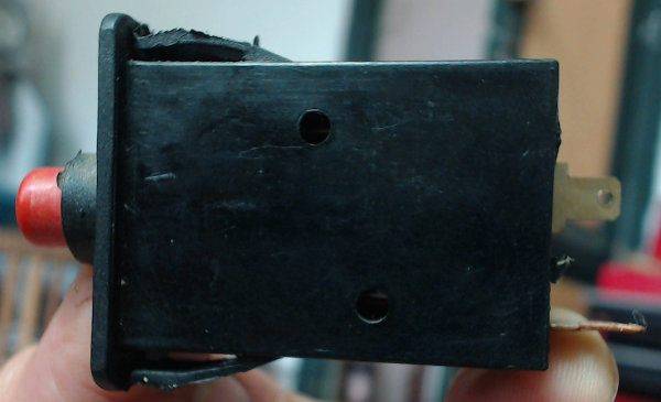

Can't tell for sure if it is a fast or slow blow fuse (looks like a fast blow) but a 15A rated fuse at 12V will allow 180 watts of motor power for a considerable time.
During testing you had observed the motor beginning to run hot somewhere in the 35 watt ballpark, so 15A provides only wire protection, and not for motor overload. I'd try a 5A fuse. Installed at the power supply it will protect against a wiring short circuit as well as motor failure/overload.
