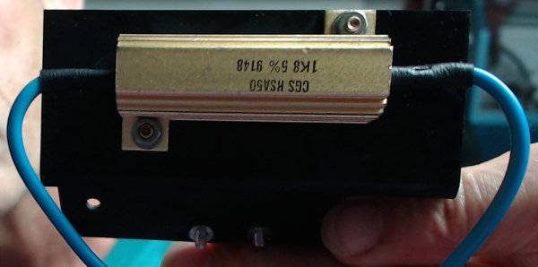

Just reading up on resistors:
It seems that I would need one rated at 400v.
If:
Current I = V/R 240/1000 = 0.24 Amps
Power consumed P = I2R = 0.242 x 1000 = 57.6 W
Is this correct?
I wonder if the resistance could be even higher - I don't understand the mathematical relationship between the resistive load, and the disharmony in the dimmed AC supply.
If:
10K Ω would consume 5.76 Watts.
100k Ω would consume 0.576 Watts
Is this correct?

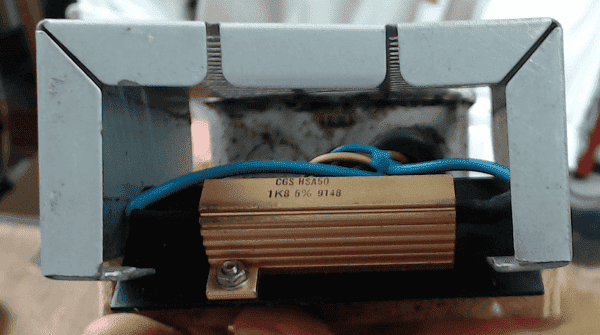

Aha i remember now.
It's "holding current" for the thyristor.
Holding current is the minimum current required to hold a thyristor in its conducting state. It will be tens of milliamps.
When current drops below that amount it will turn back off unless there's still a gate signal applied.
This is a basic lamp dimmer
(Triac is the name for a bidirectional thyristor)Capacitor C delivers a brief firing pulse to the Triac's gate terminal .
Load current through the lamp must rise to Triac's "holding current" before the end of that firing pulse.
Inductive load like a motor will postpone rise of load current because of its inductance. So the triac might turn back off .
Resistive load does not postpone current rise. So some resistance in parallel with your transformer primary will help assure reliable turn-on of the Triac.
I suspect that's what was happening when you saw those 1.3 volt DC readings, Triac misfires.

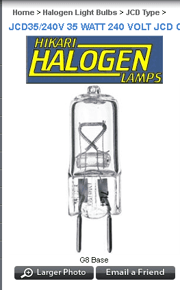

Two lamps in the battery charger enclosure would indicate that it was on!
However, I am interested to understand the difference between a lamp filament, and a resistor.
IE. is the resistor idea wrong?
The reason being that I don't have a small 240V lamp.
Neither do I have the resistors.
It is looking like we have arrived at that point in the project where something must be bought
So I can source a lamp and select it as small as possible (for easy location).
Or I can source the required resistors.

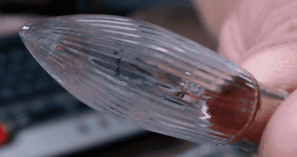

I had thought the lamps would be a lot easier to acquire. Here every Walmart and auto parts store has lamps and sockets on the shelf , resistors one has to order.
A lamp filament is just a resistor. But since resistance in most substances is a function of temperature, and since the filament goes from room temperature to maybe 4,500 degF, there's quite a resistance change.
Resistance cold is typically 1/10th what it is hot.
That can be a handy characteristic to use . It'll help your thyristor meet holding current.
You know that a 40 watt lamp worked okay. Can you try a 20 ?
Power = E2 / R
a 40 watt 230 volt lamp is nominally
40 = 2302 / R so R = 1322 ohms , probably somewhat less at your 130 volts.
20 watts would be twice that many of course.
A 40 watt resistor will cost a lot more than a light bulb.
I only leapt at automotive lamps because they're so ubiquitous. Spend a few minutes in a hardware store perusing bulbs and sockets.
There exist small halogen 6 and 12 volt bulbs for outdoor, undercounter and reading lamps , from just a few to 100 watts. I use them for troubleshooting car electrical problems. A dead lamp salvaged from a thrift shop will provide a socket .
On the low side of your transformer you'd divide those ohms above by square of the turns ratio. 240V in 12V out is ratio of about 20...
1322 / 202 = about 3.3 ohms
6 volt 30 watts ? 36/30 is only ~1.2 ohm, sounds low and might blow if dimmer ever got turned all the way up.
12 volts 50 watts 144/50 = 2.9 ohms , not bad...
At your 3 volts or so it'll just glow orange.
You already figured out how to calculate resistance and power. There's how to figure your resistance for the high and low sides.
Keep on experimenting. Lamps are good for a cheap power resistor where you don't need precision.
have fun, foremost.

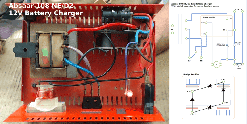

Found a 330 µF 25v capacitor on the PC PSU board.
It was difficult to desolder.
The solder cooled instantly before the solder pump could work
... but got it out.
330 µF 25v capacitor across DC output
This had a similar noise reduction effect to the lamp across the dimmed mains supply.
IE. buzzing reduction
I then added the 40 watt lamp to the dimmed mains suppy.
The noise reduced even further.
It was already only a slight hum with the lamp (as per video), but clearly, both primary and secondary sides can be cleaned up.
However - having just wired it in the capacitor 'popped'!
So it failed.
This renders some of the questions (below) irrelevant at this time.

marcophys
- 152
- 20
Notes on the popped capacitor
LTEC LZG 105 deg PET 8628D
http://www.compostar.com/Ltec/LZG.pdf
It had seen use in a PC PSU.
The top was flat when tried.
I'm wondering if I could have damaged it during soldering.
I'll look for an alternative.

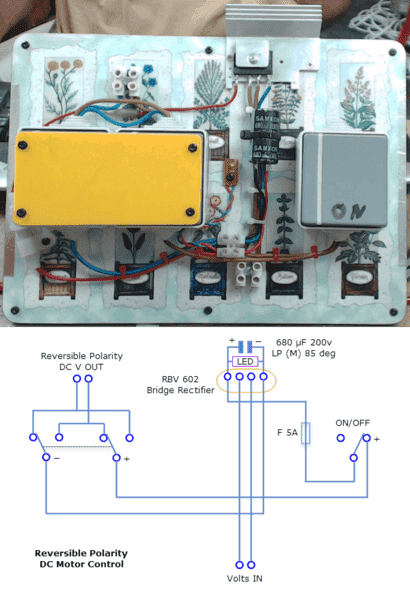

marcophys
- 152
- 20

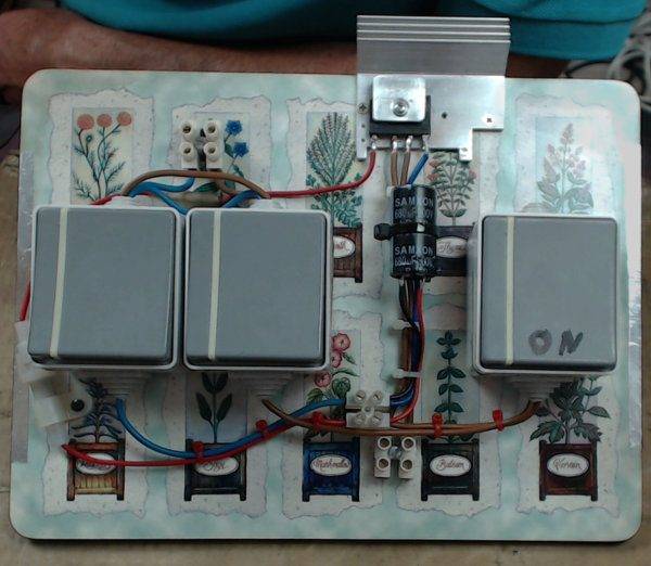

SAMXON 680 µF 200v LP (M) 85 deg (has polarity)
This was a major success vis a vis visible effect.
Test Method - Lamp & Capacitor
With 40 watt lamp across the primary
The motor was slowed to the absolute minimum.
If stopped... the motor could just restart.
The capacitor was placed across the DC output... the vibrating hum noise of the motor subsided to just a hum.
IE. the motor sounded better.
Without the 40 watt lamp and without the capacitor
The motor would not start.
The capacitor was placed across the DC output... the motor started.
Conclusion
Having a capacitor across the DC motor supply allows the motor to run better!
The SAMXON capacitor (22mm D x 41mm L) is physically much larger than the LTEC capacitor (8mm D x 16mm L).
It is 200v compared to 25v.
Also it has polarity.
The LTEC capacitor got hot.
The SAMXON capacitor remained cool.
Test Method - Lamp & Lamp
The same as above.
The primary lamp was removed... the motor would not start.
The secondary lamp was applied... the motor would not start.
To confirm... the capacitor was applied... the motor started.
Therefore it appears that the 40 watt lamp across the secondary, has no effect.
Whereas the capacitor across the secondary has a strong positive effect.
Questions
Was the choice of lamp incorrect... or is it simply the case that the capacitor provides the correct solution?
Is there any reason to test different capacitors... or has the objective been achieved?
Conclusion
The same as above.
Questions
Homework Helper
Dearly Missed
- 9,864
- 4,896
I'd say your capacitor works.
When the triac "fires" it injects a large and brief pulse of current into the capacitor to replace the charge that the motor consumed since last charging interval in the immediately previous sine wave.
. Short but intense bursts of current have high heating value, look up "Crest Factor RMS" .
Here's first hit i got and it's a pretty good explanation.
http://www.programmablepower.com/support/FAQs/DF_Crest_Factor.pdf
I suspect the "Ripple Current Rating" of your small capacitor was exceeded and that's why it got hot.
Keep an eye on the bigger one's temperature for a while. If it stays cool you're fine.
This is how we learn !
old jim
Feel the new one for heatingmarcophys said:The LTEC capacitor got hot.
old jim
marcophys
- 152
- 20
Final test of this session
Confirm the need for the dimmed mains supply 'solution'.
With the capacitor wired in parallel with the DC output & the 40 watt lamp in parallel with the dimmed mains supply ...
... the motor was slowed to absolute minimum, yet could be stopped and started.
By removing the lamp... the motor would not start.
The test was repeated.
With the lamp... the motor would start.
Without the lamp... the motor would not start.
Conclusion
A solution is required for both the AC supply to the transformer, AND the DC supply to the motor.
Notes
I note that Jim concurs that the capacitor is the correct solution for the transformer DC output.
The capacitor seems to remain very cool - no apparent change in temperature.

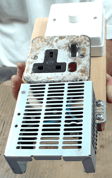

Here's the 'motor speed control panel':
For test purposes, a two way adaptor allowed a two pin socket to be placed in parallel with the dimmed mains supply.
This was an excellent solution.
The lamp holder, cable, and plug are ancient (and filthy)... but they worked perfectly, and provided a constant for all the tests that followed.
To test with, or without the lamp... the lamp plug could be easily inserted or withdrawn.
It seems that, while we can love the lamp solution because it works (and has character)... can it be replaced with something more robust?
A smaller lamp could be found, and mounted in the transformer to provide a protected environment.
... but I'm thinking that it does not provide closure.
Clearly, running at 130 volts AC it is unlikely to fail.
However, there must be a replacement that is more suitable.
I think that it is worth trying because, we no longer need to have the option for insertion and withdrawal.
It's the final leg of the development process.
However... if the lamp concept proves to be the best... perhaps an oven lamp is the ideal option:
Conclusion

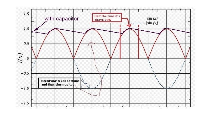

Whoops. I ought to have mentioned the same waveform ugliness the capacitor helps to filter from DC output necessitates a higher voltage rated capacitor than what one might at first expect. @jim hardy pointed out the culprit is crest factor, which can be thought of as a measure of the ugliness of an AC waveform.
Shorting poses two problems - 1. very rapid discharge rate doesn't do a capacitor any favors in terms of longevity, and 2. particularly true of capacitors used in larger equipment, enough energy is stored to melt terminals and screwdriver tip, and splash molten metal about. For cap discharging, a useful piece of kit is an insulated 50 ohm, 50W resistor with leads and alligator clips soldered to it.marcophys said:Q. Capacitor safety?

I wouldn't say either is superior to the other. Using a lamp (resistor) and capacitor in tandem should yield better results than either one alone, since each of them are attacking different aspects of the problem of low speed control quality.marcophys said:Q. Is the capacitor the superior option to Jim's concept of the lamp?

Alternative to the lamp concept
CGS HSA50 1.8k Ω resistor
Typically used as demister heating elements in camera housings, beneath the glass face of the housing.
I do believe that somewhere I have a spare.
Annoyingly, I had to raid this one from a perfectly good housing
... but they are readily available if another is needed.
I calculate that @ 130V it is consuming 9.4 watts 0.072 amps
I believe that the 40 watt lamp at 130V is consuming 11.7 watts 0.09 amps
Therefore very similar.
I wired it to another two pin plug; allowing a perfect test comparison with the lamp.
Result
It does the same job.
Both start and turn the motor at slowest speed.
The advantage is that it can be easily and securely mounted to the chassis, which in turn will dissipate the generated heat.
It would appear that this is the correct solution.
Result

This 50W wire wound resistor ought to work just fine ...marcophys said:Yes... that halogen lamp is even smaller, and would sit rigid between solid cores :)

The battery charger
We never analysed it.
I always assumed that everybody else understood it... and everything seemed straightforward.
... but came the time to begin modifications, and everything was not as it seemed (to me).
I had been metering only DC voltage
... but in fact, everything appears to be AC voltage.
I also found that 'apparently' with the addition of a switch (slot already provided)
... the charger can also provide an output of circa 6 volts DC
OR
circa 12V AC
OR
circa 24v AC
Q. Did everybody know that already?
According to the meter... anything outputted, metered as DC, is doubled when metered as AC.
The suggested wiring contacts for the lamp (by Jim) shows 0 volts DC & 14V AC.
(so it is not just a case of doubling or halving the metered voltage)
I'm just wondering why we didn't attempt to rectify the AC voltage output?
I'll make a video of all the metered results, but what are everybody's thoughts on this?
It certainly seems that with the addition of a single switch, the charger can provide 6V

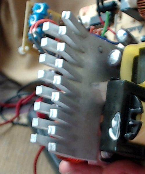

Here's the wiring diagram against the charger image:
Note the marking of the 6V & 12V outputs metered as DC.

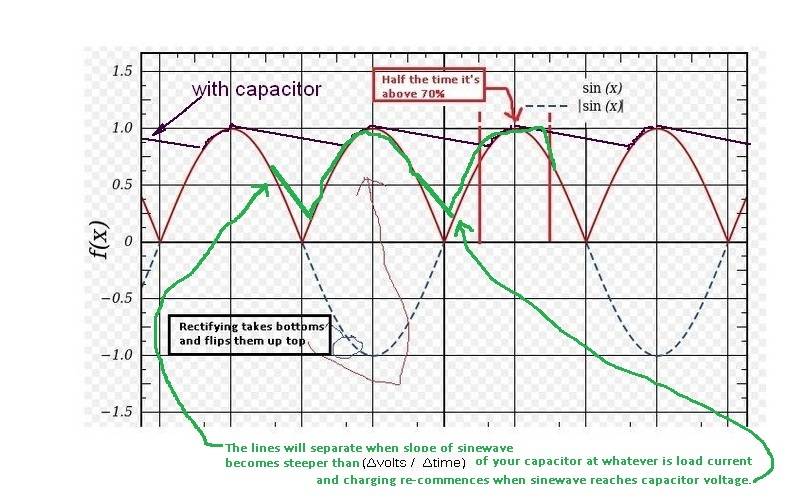

Not I. Looks to me like it'd be DC. Unfiltered DC which has a LOT of AC content, but DC. Those two heatsinks look like a rectifier.
I expected that, it's why i picked that spot. It's upstream of the rectifier.marcophys said:The suggested wiring contacts for the lamp (by Jim) shows 0 volts DC & 14V AC.
Try this...
With no load and no dimmer,
read charger output voltage with DMM set to DC. You should read around 14 volts DC.
Switch DMM to AC volts. It should read less maybe 1/3 as many volts
Now connect your capacitor across charger output + to -.
Read voltage again with DMM set to DC. You ought to read nearly 18 volts.
Switch DMM to AC volts. You should read one volt or less.
If all that happens then i understand the charger. Mother Nature loves to fool me, though.
Going back to this image for a moment
(even though likely it's upside down- dimmer is probably in the hot wire ? )
Your charger and motor are connected in place of the lamp.
When Triac fires the dimmer becomes an effective short circuit, ie voltage across it collapses.
Inductance of the motor postpones current rise so triac may misfire , as we described earlier.
I've noticed that myself using treadmill motors with a bridge and a lamp dimmer. They won't start at low settings.
Your capacitor across the motor accepts a big gulp of current at instant triac fires so i understand that part.
The resistor across transformer primary also accepts current, though less of it, so that's why Tom.G's lamp worked. I understand that.
There's probably an optimal combination of R and C. But don't argue with your success.

All readings below taken on
AC output = 29.1 V
AC output = 44.8 V
Okay Jim... I'll stop there, because the recorded AC voltages are unrelated to your theoretical projections.
Perhaps the results may indicate a different understanding.
I thought that the heat sink was a capacitor
Check my drawing for details.
(-ve to -ve & +ve to +ve show no connection when metered for resistance)
I was merely reading the meter @ AC & DC settings.
... but let's see what happens with your tests.
