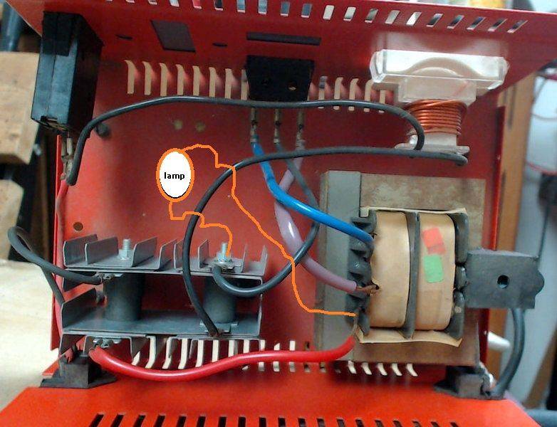

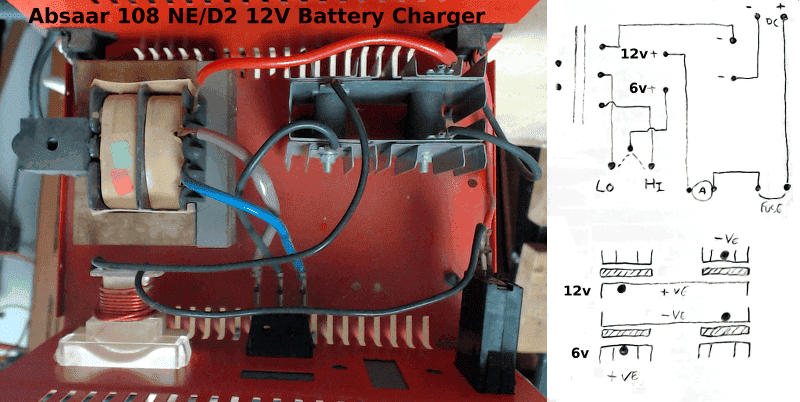

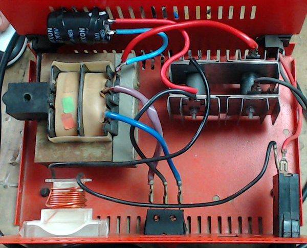

I then opened the charger.
It's a West German Absaar Type 108 NE/D2 with a push button fuse.
However, the fuse has no data on it whatsoever, but T 25 F appears on the underside data sheet.
The Fuse is top left
Wired from the Ammeter to Output.
The fuse button is out and is on a spring.
I presume it must trip on heat.
Any thoughts?

marcophys said:Re the fuse
I found a BS1362 5A fuse.
Absaar may be calling the red buttoned device a fuse, but it actually is a push-to-reset circuit breaker wired in series with the charger DC output. Can't say what the "T 25 F" marking means. 25A seems a high current rating for this purpose; Absaar type 108 charging output is 11 amps, and a 15A breaker sounds about right. If the charger is operational with the button out then either it comes out farther when in the tripped state, or it is tripped, but the breaker contacts are welded together.
Many circuit breakers are thermal-magnetic in nature. Long-duration, marginal overloads cause trips due to thermal effects while magnetic principles are used to quickly clear severe overloads and short circuits.marcophys said:I presume it must trip on heat.
Is the BS1362, 5A fuse in the line cord plug? Or are you asking whether one of these are appropriately rated to provide motor protection?marcophys said:Should I still install the BS1362 5A fuse?
marcophys
- 152
- 20
RE T 25 F
I found this catalogue:
http://www.sensata.com/download/klixon-circuit-breaker-thermal-catalog.pdf
On page 4 it shows all the breakers with very similar red buttons.
On page 6 & 7 there are the specs showing temperature rating at 25 deg C
Perhaps therefore: T (temp) 25 F (fuse)
Re potentially welded together
I note that the Klixon buttons are a similar distance out.
This isn't hard data, but...
Certainly my fuse button seems to be out a good distance (6mm).
I have spoken to Absaar, but the charger is pre the experience of the technician.
So I've sent him an email with the photos etc.

Found a dimmer switch rated 250V AC 40 - 250W
Can this be used?
Can this be used?
marcophys
- 152
- 20
Diaphragm made, exactly as first suggested.
I put a 3.5mm breather in the furthest corner from the gear box.
I then blew in.
... nothing at first (and I was thinking what?)... and then that was it; the cavity was filled and pressurised.
So the enclosure can breath, while the motor remains sealed.
Warm air or cold air, the diaphragm will absorb the pressure differential.
This should prevent any ingress of media between the seals and drive shaft.
I then blew in.
Homework Helper
Dearly Missed
- 9,864
- 4,896
It will be an experiment with i'd estimate 60% chance of success.marcophys said:Found a dimmer switch rated 250V AC 40 - 250W
Can this be used?
It'll either work fine or wreck the dimmer, so if it's one you already have and don't mind sacrificing...
I have an extension cord with a lamp dimmer & receptacle in a box at one end just for experiments like this. One side of receptacle gets full voltage, other side is through dimmer. In US that's easy because our receptacles provide for separate feeds.
Try it with a lamp first . Then set it to minimum , plug in the charger and bring voltage up slowly while listening for unusual humming in your transformer.
Asymmetry in the dimmer output will make the transformer hum and run hot but it should self-announce by those symptoms..
You might feel a little line frequency vibration in your motor but that's expected.
Keep this thing safe. PF is wary about inexperienced people working with line voltage.
Be sure you put the dimmer and receptacle in an outlet box and all connections are safe from tiny fingers in your household that are curious...
Your work in post #29 looks pretty good so i don't mind suggesting you give it a try.
I think over there you have fused appliance cords - one of those sounds like a good safety feature. I don't like 240 volts , the sparks are too big for me...

Tom.G said:Just add an incandescent lamp (60W - 100W ?) as a parallel load for the dimmer. That reduces the inductive load phase shift and makes the dimmer behave much better.
Wiring a 40W lamp in parallel to the Transformer feed
Haha... thanks Tom... it worked!
The buzzing dropped substantially - barely perceptible (as you'll see in the video below)
You've just jumped the development process... thanks for contributing

Therefore, not only does a parallel lamp aid the transformer...
... it also aids the motor.
Having repeated the tests... there is a very clear difference between 'with and without' the lamp.
This means that the secondary coil is affected by the lamp - fact!
