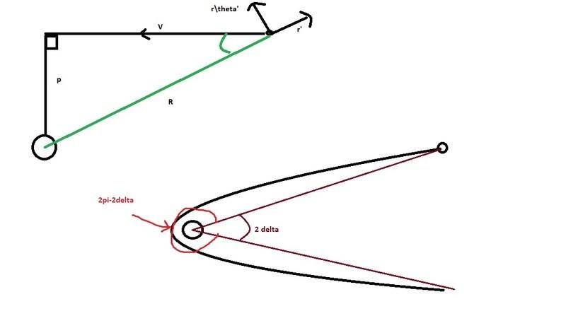

A comet is approaching the Sun from a vast distance with velocity V. If the Sun exerted no force on the comet it would continue with uniform velocity V and its distance of closest approach to the Sun would be p. Find the path of the comet and the angle through which it is deflected.
[itex]\frac{d^{2}u}{d\theta^{2}}+u=\frac{\gamma}{h^{2}}[/itex], where [itex]\gamma=GM[/itex]
[itex]u=\frac{\gamma}{h^{2}}+A\cos{\theta}+B\sin{\theta}[/itex]
Since [itex]\dot{r}=-Vcos{\alpha}≈-V[/itex] where [itex]\alpha[/itex] = the angle between
V and R (R is the distance from the Sun to the comet, green angle in the diagram).
Using [itex]\alpha[/itex]≈0 → [itex]h=RV\sin{\alpha}=pV[/itex]
At t=0, choose [itex]\theta=0[/itex] and u=1/R≈0, du/dθ=-[itex]\dot{r}[/itex]/h=1/p
→[itex]u=\frac{\gamma}{p^{2}V^{2}}-\frac{\gamma}<br /> <br /> {p^{2}V^{2}}\cos{\theta}+\frac{1}{p}\sin{\theta}[/itex]
Then u → 0 again, when θ=0, or 2∏-2δ, where [itex]\tan{\delta}=\frac{pV^{2}}{\gamma}<br /> [/itex] Where 2δ is shown below.
and [itex]h=r^{2}\dot{\theta}[/itex] In the usual polar coordinates.
What I do not understand is the definition of δ. Especially when it comes to introduction of tanδ ... Can someone explain why we can write tanδ as above ?
I tried to provide as accurate drawing with my paint skills as I could. It was drawn in such a way, the deflected path almost intersected the straight line (almost like a reflection h, where a connect the shortest side with the unique angle of an isosceles triangle )
This example is actually taken from M.Lunn's A First Course in Mechanics, 1991, p33-34.

Yes, y should have been u, sorry for the mistake.
I scanned the problem with the most important parts included.
Simon, I get the tanδ epression in terms of p and r, however, I do not get the on in terms of pV^2 and GM
http://img835.imageshack.us/img835/7707/probn.gif
the delta is the half-angle between the asymptotes of the hyperbolic trajectory.

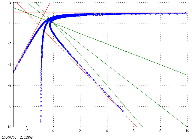

I had a fiddle with octave to print a better representations for you:
The blue "o"'s represent the position of the comet at equal times. The comet enters horizontally from the right, bends around the mass, and exits lower.
The first plot shows you three trajectories with tanδ=1.5, 1 and 0.5 from widest to tightest. Since M and p are the same for each run, these correspond to different incoming speeds.
The mass is at the black "o", the red lines are asymptotes, and the green line is the symmetry axis of the trajectory. δ is the angle between the green line and the red ones.
The second plot isolates the tanδ = 0.5 one so you can see it clearer.
Plots generated from the following code.

Wow, I really appreciate that you took the time to graph and explain. When looking at graph 2.8 I had no idea how was that supposed to be the 'half-angle'.
I kept wanting to draw diagrams on a whiteboard - and when I saw the diagram they gave you it was pretty obvious what the problem was.
You said, that those are the shorter sides of a right triangle, but how did you know which one is which ?
Definition of the tangent. Remember SOH CAH TOA?
How did you manage to express that while having u untouched, and 1/p changed to one, in front of the sin(θ) term ?
In order to investigate an equation, you can put any values in that you like. The trick is finding useful values.
p is what we call an "impact parameter" - it is how close the comet would have got if it was not deflected. For an arbitrary value p [tex]u=\frac{1}{p}(F-F\cos\theta + \sin\theta) \; : \qquad F=\frac{\gamma}{pV^2} = \frac{1}{\tan\delta}[/tex] So doubling p just halves u, and doubles r=1/u, so it is a scale factor. All values give me exactly the same shape, just bigger or smaller.
By putting p=1, I was basically defining the unit of distance on the graph. So if your comet would have passed at 1AU, then the x and y-axis are labelled in AU and V is in AU/time. If it would have passed 1 light-second away, then the x and y labels are in light-seconds and V would be in light-seconds/time. See?
To investigate the equation, now, I just need to play with V[tex]F=1 \Rightarrow V=\sqrt{\frac{\gamma}{p}}[/tex] and, of course, p=1. So the initial speed is the square-root of an energy term. If it is exactly this square-root, then the deflection angle is exactly π/2 radiens.
To put this in terms of energy, just multiply both sides by m/2 so that this means:[tex]\frac{1}{2}mV^2 = \frac{1}{2}\frac{GMm}{p}[/itex]... the LHS is the initial kinetic energy and the RHS is half the potential energy at distance p.<br /> <br /> That should put you well on your way.[/tex]
