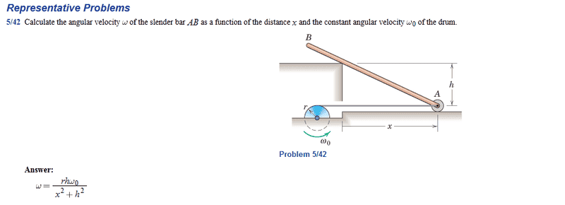

Calculate the angular velocity w of the slender bar Ab as a function of the distance x and the constant angular velocity w0 of the drum.
I have attached an image of the question
x = √(x2+h2)cos(θ)
x' = -√(x2+h2)sin(θ)θ'
θ' = -x'/√(x2+h2)sin(θ)
θ' = -x'/h
But I'm not sure where to go from here. I'm having trouble dealing with x'.
Any advice would be appreciated.

When taking the time derivative, you neglected the time dependence of x on the right side of the equation. It will be easier if you start over and use a different trig function than cosine.
Do you mean something like:
x = h/tan(θ)
Yes. And 1/tanθ equals another trig function.
Do you mean 1/tan(θ) = cos(θ)/sin(θ) ?
No. cotθ
With this information I've managed to get:
x = h/tan(θ)
x = hcot(θ)
x' = -hcsc(θ)
θ' = -x'/hcsc(θ)
θ' = -x'sin2(θ)/h
And I know that h = √(x2+h2)sin(θ)
θ' = (-x'sin2(θ))/√(x2+h2)sin(θ)
Which simplifies to:
θ' = -x'sin(θ)/√x2+h2)
I also recognized that sin(θ) = h/√(x2+h2)
θ' = -x'h/(x2+h2)
At this point I'm a little unsure of the x' and what to substitute it with. I know that:
v = wXr = rwcos(θ)
I'm unsure if what I've written here for v is correct. Particularly, as the given answer does not have a cos(θ) in it.
Could someone clarify this for me?
x'= v = tangential speed of rim of drum = rω
Note: from the equation θ' = -x'sin2(θ)/h it would be easier to substitute for sinθ rather than substitute for h.
