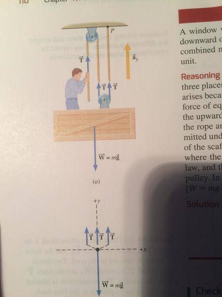

Explain why the force diagram is as shown:
Free-body diagram of a man pulling a rope over pulleys to lift a wooden crate, with tension forces T and weight W = mg labelled, and a +y axis diagram below showing three upward T vectors and downward W.
http://[ATTACH=full]199944[/ATTACH]
[h2]Homework Equations[/h2][h2]The Attempt at a Solution[/h2]
[/B]
For the system, the gravity vector makes sense. However, I don not understand exactly why there are three tension forces. First of all, to me, it would seem that the first force is the force due to friction between the person's hands and the rope. I do not see what the force has to do with tension. Second of all, why are there two tension forces where the bottom pulley is? Shouldn't there only be one? How come there are two? I doon't really understand how tension works, so it is confusing me.
  • Free-body diagram of a man pulling a rope over two pulleys to lift a wooden crate, with tension vectors T on the rope and crate, weight W = mg downward, and acceleration a upward; below, a force diagram of the crate with +y and +x axes.
The hands versus the rope: think Newton's third law.
For the second question, consider that the tension along a rope must the the same (assuming the pulleys are frictionless), otherwise it would move
