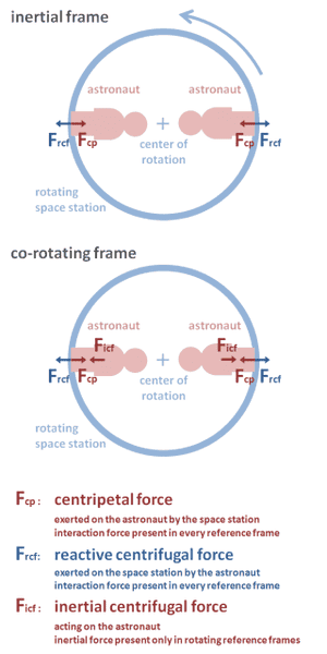

Interaction forces (also called “real forces“, but I prefer the term “interaction” as it is less philosophical and more descriptive) arise from interactions between objects. Importantly these interactions follow Newton’s 3rd law and they come in pairs.
Inertial forces (also called “fictitious forces”, but I prefer the term “inertial” as it is less dismissive and more descriptive) arise from the choice of reference frame and disappear in an inertial frame. They do not come in pairs nor follow Newton’s third law.
Importantly, the acceleration produced by inertial forces can not be detected by accelerometers.
Consider a rock on the end of a string being spun in a circle (in the absence of gravity). In an inertial frame the rock is accelerating inward. There is an inward-pointing interaction force from the string acting on the rock, this is the centripetal force. (Edit) An accelerometer on the rock detects the inward acceleration produced by this force.
By Newton’s 3rd law there is an outward-pointing interaction force from the rock acting on the string. This is the reactive centrifugal force. Note that it is an interaction force.
In a co-rotating frame the rock is stationary. It is still acted on by the centripetal interaction force from the rope. In order to explain its motion in this frame we need to invoke an outward pointing inertial force called the inertial centrifugal force. This force does not result from any interaction, it does not have a 3rd law pair, it is not detected by the accelerometer, and it only exists in the rotating reference frame. That said, it is necessary for describing the motion of the rock in the rotating reference frame

A.T. said:
1)is co-rotating frame same name for rotating frame and non-inertial frame?
2)why in co-roating frame we have Frcf?
Isnt Fcp=Ficf or Fcp=Ficf+Frcf ?
I never see in tasks using Frcf for roating frames?
Co-rotating means rotating with the space station. All 3 bodies are at rest in that frame, so the forces on each of them must balance.
Because it's a frame invariant interaction force. It can be measured with a scale at the wall of the station, and that scale will read the same in every frame.
Where is reactive centrifugal force in co-rotating frame in your discription, A.T. picture say that reactive centifugal force exist in every frame?
So what is realtion of magnitudes of Ficf and Frcf,are they equal?
So what is realtion of magnitudes of Ficf and Frcf, are they equal?
There is no general relation between their magnitudes, even if they are equal in some cases. Also note that they act on different bodies.
So what is free body diagram for astronaut in co-roataing frame?
Fcp= Frcf or Fcp=Ficf + Frcf ?
Frcf is not acting on the astronaut. The red forces act on the astronaut:
Fcp + Ficf = 0
Yes, it is the third law reaction force to the centripetal force. So it is exerted by the rock on the rope in all frames.
in my logic Frcf and Ficf are same force and must be same in magnitude
Your logic has some gaps:
1) they act on different objects
2) the reactive force exists in all frames
3) the inertial force exists only in rotating frames
4) the inertial force violates Newton’s 3rd law
show me equation for magnitude for Ficf and Frcf
The magnitude of Frcf depends on the rotation rate of the station.
The magnitude of Ficf depends on the rotation rate of the chosen reference frame.
Their magnitudes are not the same in general, just in some reference frames.
And as already said, they act on different objects.
so If we put weight scale between astronaut feet and station wall,scale will show Frcf and it will be
mass x Vsquare / radius ?
(assumption that weight scale is massless)
It will show ##F_{\mathrm{rcf}}=F_{\mathrm{cp}}=m\omega_{\mathrm{station}}^2r=mv_{\mathrm{station}}^2/r##, yes. It will show this whatever frame you choose to use.
