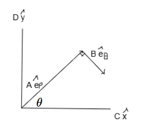

1)Yes you are correct, I made that mistake.
2)Here are the cylindrical unit vectors expressed in Cartesian unit vectors.
C=Asinθ+Bcosθ
D=Acosθ-Bsinθ
Unit vectors, therefore A=B=1;
C=sinθ+cosθ
D=cosθ-sinθ
